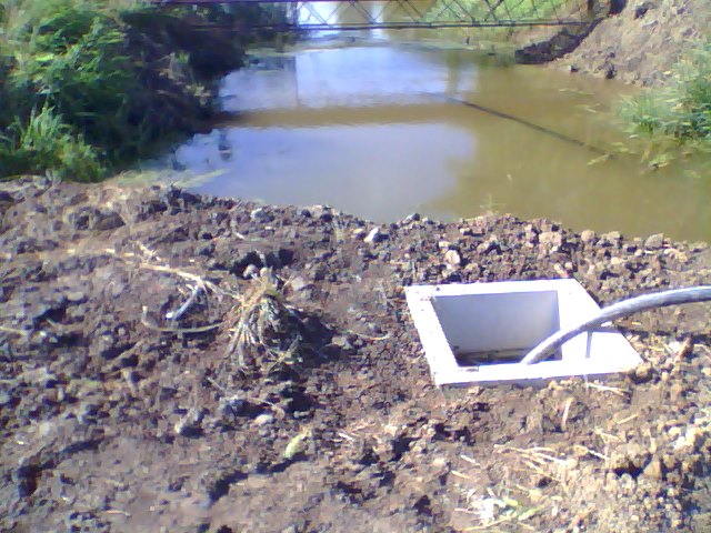

I am expecting delivery of 4 Canadian solar 255 watt panels on Monday [ sounds like similar panels] . Panels, connector harness , end caps , mounting brackets[to wood frame] $ 1006.00 . we are building a solar powered dewatering pumping system for one of our farms . The pump and controller are also on order . The system will be for day use only, no batteries . We are hoping for 50 gal. min . We will keep our 300 gal. per min. diesel pump for back up .. sorry creeky no life batteries needed . I am not up on all the particulars my son has a electronics business and he has done the research . I am just hoping it will cut down on the fuel bill . Good luck with your system Steve..

# Posted: 26 Jul 2015 09:13pm - Edited by: Just
We bought the panels local , there is a Canadian dealer for the pumps but he doubles the price . The system is to drain field tile in a 50 ac. farm . Lake levels have risen so high the tile are no longer working without a pump.
new basin for the pump
