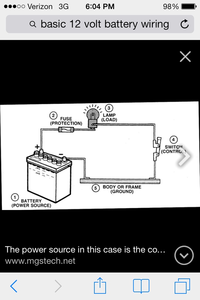

Thanks Salty Craig I will do some more reading and look into some other lighting.I do have this diagram I found some where I was thinking l this is about what you are talking about. When I found that light to be so hot I thought I may be needing something else like a voltage regulator of some kind. It make sense about the light and why it was so hot. So I thank you for that info.

You're welcome. In that diagram they are switching the ground. I believe switching the hot side is a much better idea. Both work.
