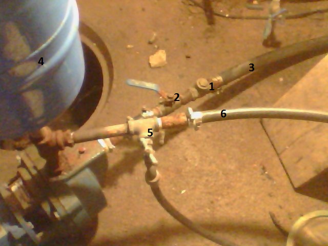

# Posted: 24 Jun 2015 10:08pm - Edited by: Just
1 check valve.[ i have mine at the top of the well]
2 restriction valve. [set at 3 gals. per min. with a 1 horse 8 gal. pump]
3 1 in. line to well .
4 small pressure tank [ I also have a large 40 gal. bladder tank .
5 tee and tap beside the pump..
6 line to house
may help get your head around my gibberish .
# Posted: 24 Jun 2015 10:24pm - Edited by: Gary O
1 check valve.[ i have mine at the top of the well] CHECK
2 restriction valve. [set at 3 gals. per min. with a 1 horse 8 gal. pump] CHECK
3 1 in. line to well . CHECK
4 small pressure tank [ I also have a large 40 gal. bladder tank . CHECK
5 tee and tap beside the pump.. CHECK
6 line to house CHECK
no gibberish, I read slow, so appreciate you typing slow

'...and no, you do not need a pressure tank for what you're doing.'
Then him (Richard), the kid (Ricardo) and I spent around two hours getting what I needed.
No, my set up is not the all-encompassing ideal.
But,
We're going to have water tomorrow
Gonna be the hottest day of the year so far (100°F) and we plan to have a garden hose water fight by 2pm...
Or
Travel another 100 miles for whatever I forgot, or boogered up...
I got the ¾ horse, a compromise from 1 horse and ½ horse, and enough fittings for options down the line...like winter.
http://www.homedepot.com/p/Everbilt-3-4-HP-Shallow-Well-Jet-Pump-J200A3/204478353

Good looking pump has a large casting , means it holds a extra quart of water to protect the pump frpm over heating.. ..
