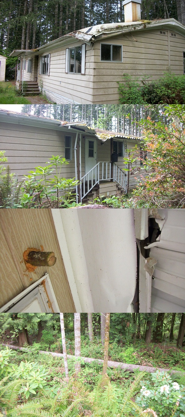

My place used to look like that, it felt like living in a rabbit hole till I had the front half of the property logged off, that was twelve years ago, no more getting dark at 2:30 p.m. year round, my mood changed over night from grouchy S.O.B. to not so grouchy S.O.B., that was twelve years ago and never regretted it, new vegitation has come along nicely, lots more birds and wildlife and my solar though still not the ideal setup has done 110% of asked 24 /7.
Regarding the trees, I loved them till they started falling on my house and ultimately totaled it so am a believer in house here trees there.

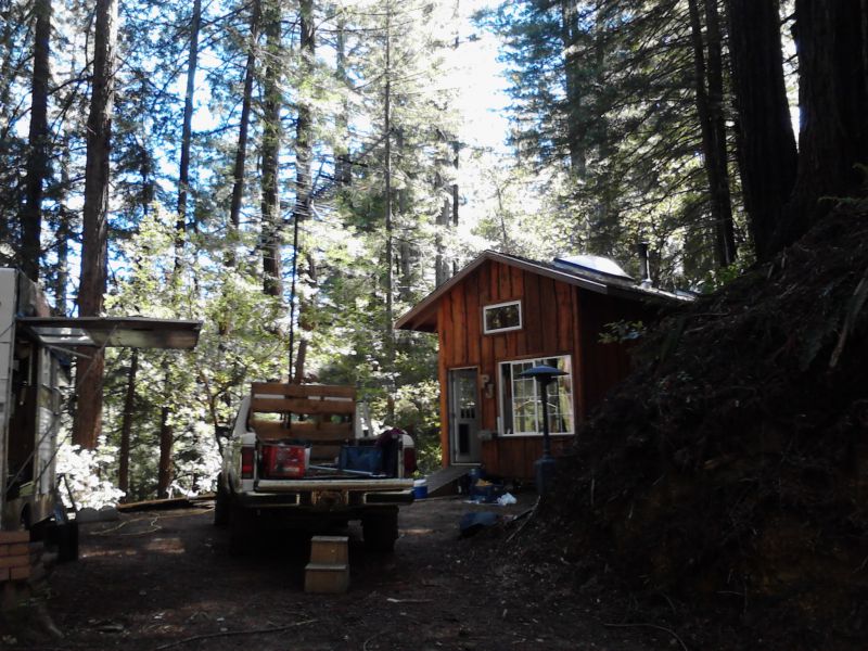

If I had some Latitude and longitude I could get a satellite fix and see more clearly but the shot of your cabin indicates you have decent exposure just that they Pit set your cabin so it is setting below ground level or is dug into a hillside judging by the the berm to the right of the truck and the large trees looming above the cabin with chopped roots, you have a lot bigger problems than power and they are the trees on the high ground surrounding the cabin, they should be taken back at least the distance of the tallest tree soon.
My place got hit five years ago by a 85 m.p.h. micro burst two trees came down on the rear center and punched over thirty holes in the roof and drove one limb through the rear canopy and through the wall (kept it as a reminder), and just when I thought all was clear another came down and took off the corner of the place while this year fortunately another 80 footer dropped just behind the place.
The place was deemed unsafe even if repaired due to the proximity of surrounding trees was black listed as a hazardous zone by the insurance company so now the place is kept weather tight and used for storage.

Because the root systems have been disturbed either by cutting on the high slope or stacking dirt on root systems (which will suffocate a tree) the best rule to protect your cabin is to remove far enough way from your cabin that a tree can not strike your cabin from any angle, don't leave trees standing if they are not in groups, singles need the group to resist high winds, might check with a state forester for advice but this is pretty much common sense rule of thumb.
