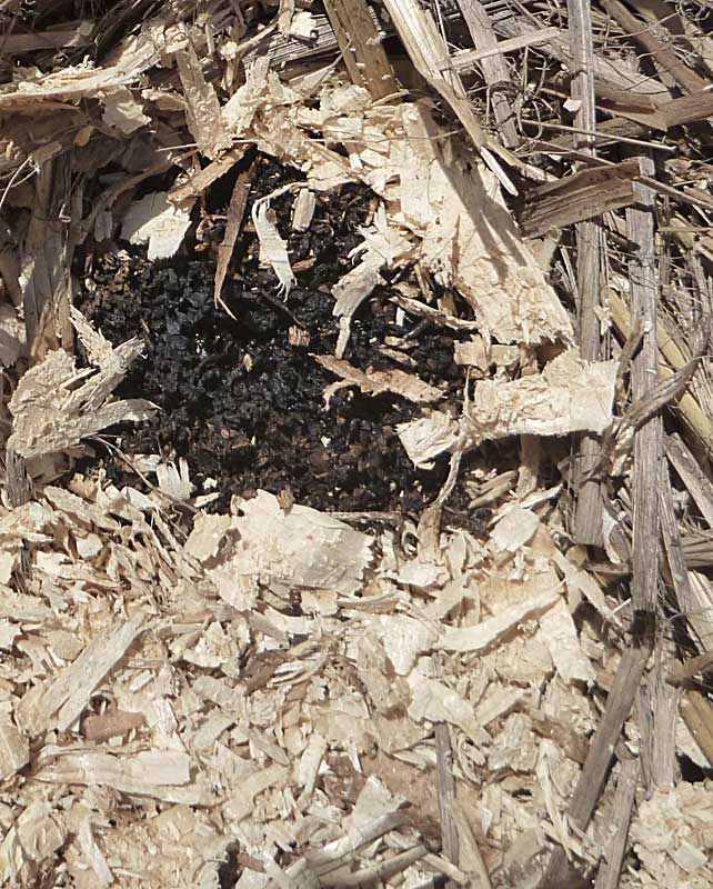

# Posted: 29 Apr 2015 08:29pm
well. this will be my final update to this topic.
first: i am surprised how well the bokashi experiment has worked.
second: anyone using the bucket toilet or a composting toilet design this bokashi technique is worth doing. it really eliminates smells. and the "material" digests remarkably fast.
I used the "sawdust" bucket toilet for three months this winter and using the bokashi inoculated material to cover was a definite benefit.
i attach a "material" picture. this material has sat covered in the bokashi mixture for 10 days. You can see I have unearthed a bit. You will also note that it does not look anything like "bowel excavations" it looks like ... compost.
if there's a smell it's slightly nutty. the texture is firm, the colour black. quite unlike what untreated material looks like.
please see my bokashi blog post for photos and the recipe i used for making the inoculant. It is really easy to make. And very easy to use.
if you have a situation where you need to manage human waste in a safe and simple fashion. this is well worth looking at.
note: i tested my recipe a second time. it seems to be working, but I would recommend ensuring you age your rice water for the full week to 10 days.
hope this helps.
