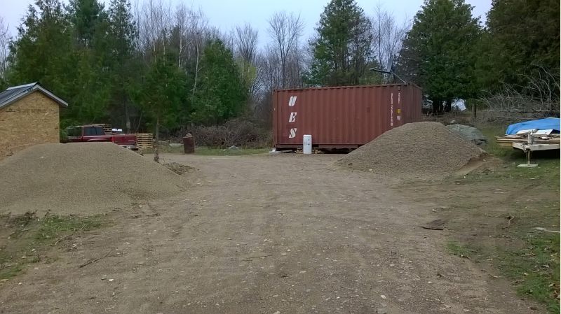

Fortunately the location of my Sea Can has excellent South Exposure and clear from East to West... South Facing hill. Attached is a photo showing the 20 footer - the trees are on the north side going over the hill top. Cabin is going West of the Sea Can, Pump House (little bldg. to left) is south of the Sea Can.
Prior to my moving into the temp shelter I'm in now, I was using an average of 10Kwh a day with very outdated and inefficient appliances. Heck the old fridge used 150Kw a month - my new fridge uses 310kwh a YEAR. Everything I have is Low Power - except for my Graphics Workstation which is a seriously HD Computer but used only when & as needed. @ the Cabin, cooking, heating, hot water will be non-electric.
Does not matter where things are made, that's no quality guarantee, the brand name and quality feedback are essential.
