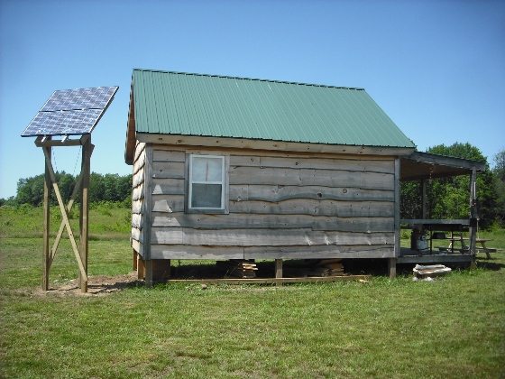

i just received a 60w panel kit (sunforce ordered off amazon).
my 12x28 cabin roof is east west facing so i plan to build a mounting frame that is south facing. my solar panels are 4 15w panels on a flimsy pvc frame. i have some ideas in mind, but i am hoping some one else with better ideas has solved a similar problem previously and can offer suggestions.
also, i plan to run the wires in pvc conduit to reduce rodent exposure. any other suggestions - is galvanized better. i will not have to run more than a 10-15 feet or less.
thanks for the help. -b
dk1393
# Posted: 13 Jul 2010 03:32pm
You can see how I mounted mine . I used a solar panel mounting kit , but some aluminium channel should work good and be cheaper. I did not run the wires in conduit. At the time it did not cross my mind. Its a good idea
