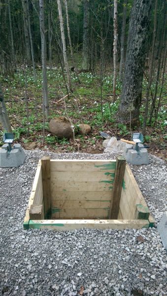

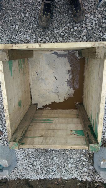

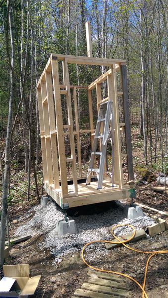

Hello all. I recently began digging a pit for an outhouse build that I am working on (pics attached) and realized that after 4.5 to 5 feet the pit fills to at least a foot or two of the bottom with water. I am guessing that the water table must be very high, especially due to the fact that it is spring.
I have looked everywhere online to see if there was any advice on the pros and cons of having a wet pit in place of a dry pit for an outhouse. We do not have a well and our property is far from other's land or any body of water so sanitation does not appear to be a factor. Apart from building code requirements can anyone see any downside. I am thinking that as the seasons change the water level will drop and over the years the water variation will actually help flush the system.
Any advice or thoughts would be appreciated. Thank you.

Every out house I've ever seen here in Northern MN, has had water in it in the spring. It's never been a problem in mine. I'll bet it will dry out in a couple weeks. Nice job , by the way.

Mine does the same. High water table for the first month of spring, bone dry the rest of the year.
Just watch for splashback, seriously.

Having water in the pit bottom is a recipe for ground water pollution. The water can carry pollution from the pit great distances. US Army latrine building instructions also prohibit digging into the water table level.
Sounds like that should be filled in and a composting toilet system built instead. Or simply fill until above the high water table level by the required amount and using shallow pits. Probably have to move the privy more frequently, but that is better than crapping in the ground water. You do not want water "flushing" the waste in the pit before the bacterial action has broken down the waste. This is one reason why rain water must be diverted away from the pit.
Is there a well on site? Distance? Uphill / downhill? Whatever is downhill will get dosed good with whatever crap is in the water filled pit.
