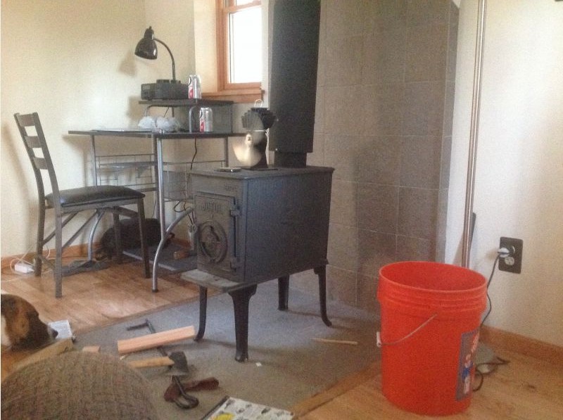

Wood stove like the Jotul 602 would heat your place easily. My 602 heats a 14x18 so hot I can't stand it. I do have lots of insulation so YMMV a bit.

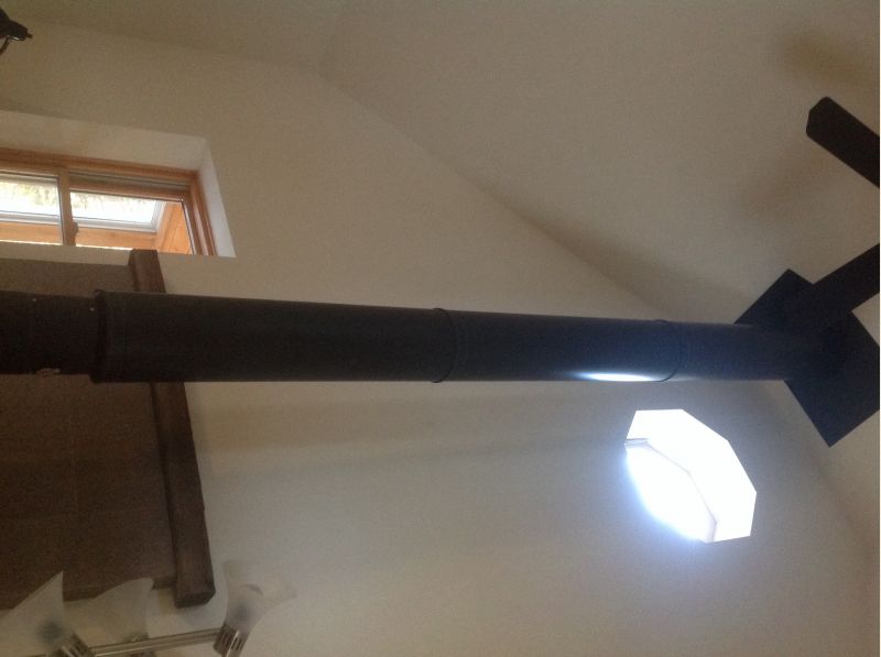

Just took a pic of my setup from my easy chair...it's -2 outside and 75 inside . My install is 36" wide and the hearth extends 46". The stove only sticks out 32" into the room. I'm using double wall pipe and class a chimney pipe. If I went to single wall pipe there's more heat to be extracted, I just don't need it.
If you are worried about overnight burns just have the Mr buddy as backup. The wood stove will keep the air dry enough to handle the excess humidity from it.

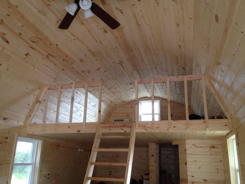

I use a 20,000 btu vent free heater in my 12x24 shabin here in Minnesota without any issue. I did insulate well and used sheet foam for the roof area that is only r-11 but allows for space between sheeting and foam for air to move. Its been below zero every night I have stayed there this winter and no moisture issues. The whole inside is knotty pine so that adds an extra insulation value because its 3/4 inch thick. The only thing I can think of that may help in my case is I have power. I run a 54'' ceiling fan all the time to help keep the temp more even up in the loft. Hope you find something that works well for you! This is a photo of our layout.
