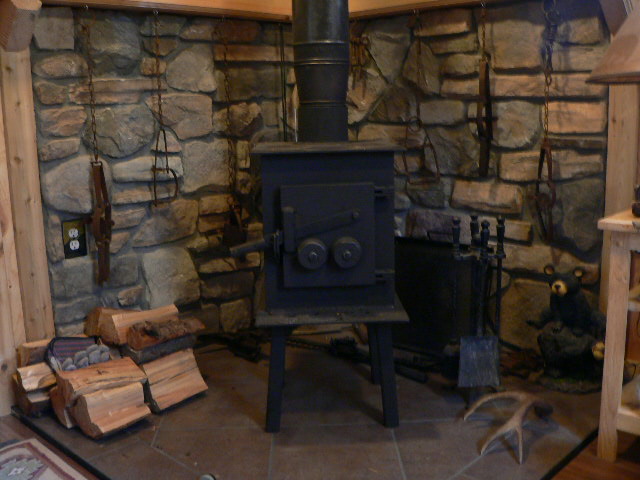

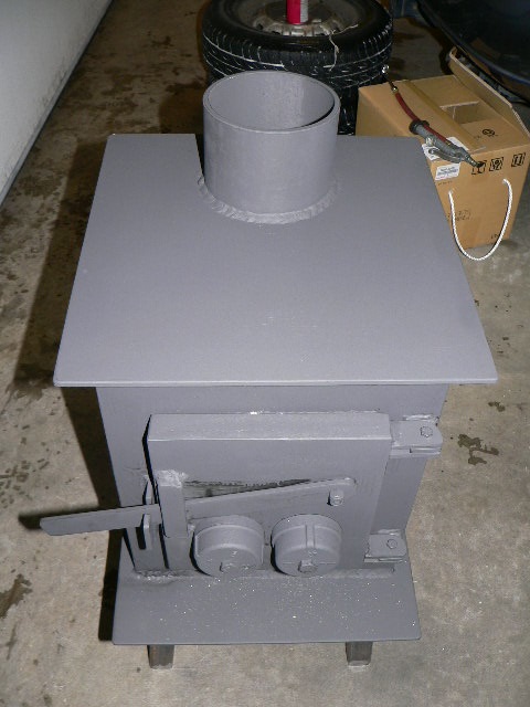

mattd, you can fix metal shields to your woodstove, this means permanently secured, not just some shield bent that just sets there (freestanding) this will reduce setback, how much? Who knows, but it should help to tighten it up (give you more room)
I never could find the right size, couldnt find one air tight enough, and I wanted it in 1/4" plate steel, no cast iron, could only find cast iron, multi piece, so I made my own.
