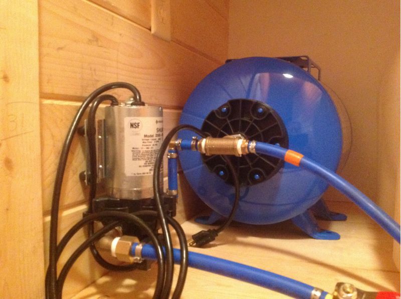

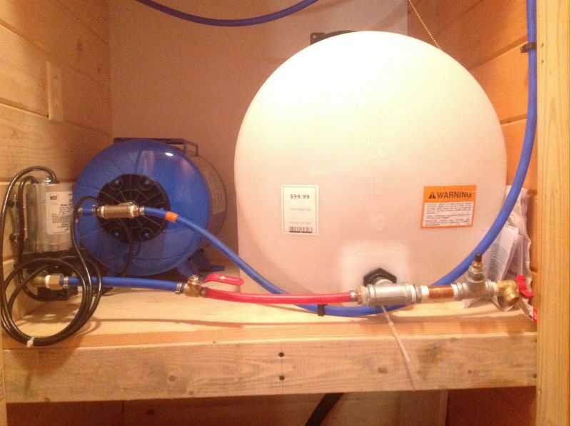

I purchase a SHURflo pump model # 2088-594-144 Complete with 6' Power Cord on eBay for $119. (Don't forget a strainer/filter like I did).
A 5 gallon pressure tank at lowes for $48, a 35 gallon leg style holding tank from Tractor supply for $99 http://www.tractorsupply.com/en/store/leg-style-storage-tank-35-gal?cm_vc=-10005
A 19 gallon hot water heater for $260 at lowes.
I plumbed everything with pex. Never did any of this before and all works great with plenty of pressure at faucets, still need to hook up water heater.
I also set up so I can drain and put air pressure thru system to help clear out all water. I have to double check the way I have this setup to make sure the air pressure will not damage shurflow pump before I use it.

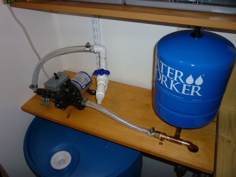

Yours is very similar to mine, except I don't have a hot water heater. I have a 30 gallon water drum, 12V SHURflo pump, and a 2 gallon pressure tank. One thing I added to mine was an alternate feed line to the pump. This is so I can draw water from a bucket with heated water, such as from the wood stove in winter, to take a warm shower if necessary. It also makes it easy to introduce RV antifreeze into my system to winterize it.

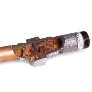

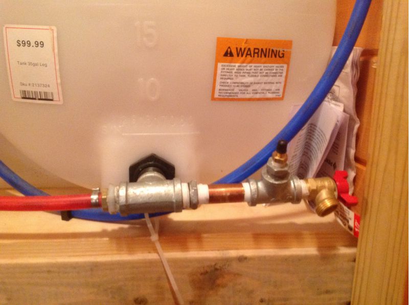

OK, I see an area of potential problems. Coming out of your tank, you have a galvanized "T" fitting with a copper reducer hooked to copper stub pipe into another galvanized pipe section. Hooking galvanized pipe to copper is a no no and you will have corrosion (dissimilar metals) and eventually a small leak. The corrosion and leak is certain, if you must tie galvie to copper, they usually install a bronze piece between, that buys you lots of time, but still corrodes.
Otherwise, looks great. I love PEX, especially the colored stuff for hot and cold. I like your crimped fittings too, much lower cost than the shark bite.

Go ahead and do some studying on galvanic corrosion. It doesnt take long.
http://www.familyhandyman.com/plumbing/repair/join-galvanized-pipe-to-copper-pipe/vie w-all

Sorry if I sounded like sarcasm, didn't mean to. I really do appreciate your suggestions. How would you recommend fixing this? All galvanized or plastic? Does same problem happen when you attach bronze with galvanized?

Cabinfun, I'd just remove the 2 galvanized T's you have. Get 2 copper T's to replace them, but you will need to sweat (solder) in the 3 female threaded ends onto each T, to replicate the galvanized T's you are replacing. Then they will go right in the same spot as your galvies with no other adapters, reducers etc. to buy. The crimped fitting at the end of your PEX will turn right in place and wont leak. The crimped in end will spin right inside the PEX, another great advantage of PEX. So you can remove the galavanized pipe without having to undo any of your PEX crimps. This makes it super easy to change out.
Brass to copper and bronze to copper is not an issue.
Copper or PEX is great stuff, basically use anything but galvanized. Galvanized is only to repair existing galvie pipes currently in homes.
