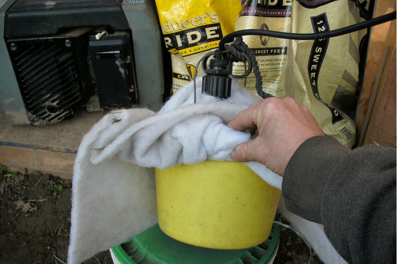

This is what I use.It is a small 6 inch od, 1/2 horse sump pump stuck in a 2 gallon plastic bucket with a piece of filter material wrapped tightly sealed around the opening of the pail.I plug it into my 40 pound genny.hook it to a garden hose,toss it into the water and there yah goo!

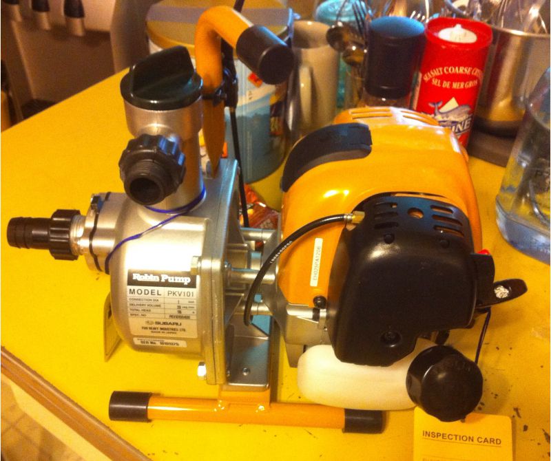

Here is what we use to pump water from the lake to our 250 gallon water tank. It is Subaru PKV101. Got it Online from waterpumpsdirect.com
It is a little pricy but is an amazing pump. I have other photos posted in my water tower thread.
