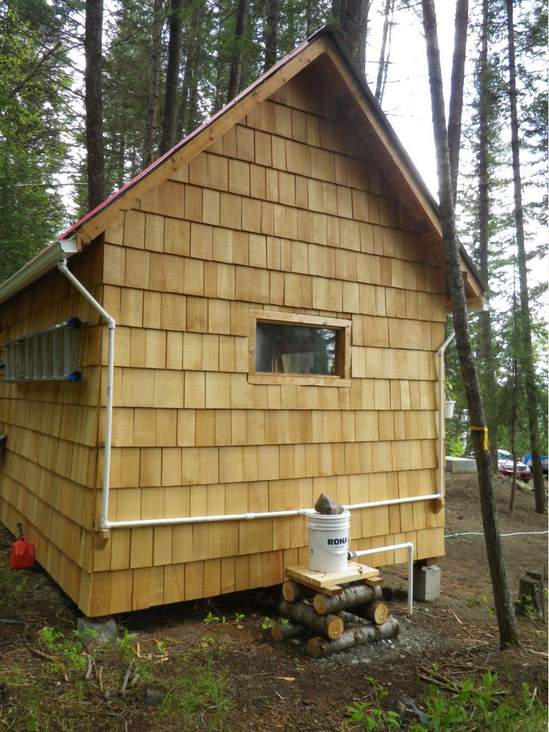

I have installed a 1500 gal, 6000 litre, underground tank purchased through Barr plastics in abbotsford ( built by Graf )designed for burial and potable water. It's about 8' in diameter with a 24" dome. The water level tends to be 3-4 ft below ground level for frost protection. I take water from the gutters(metal roof) with "gutter guards" to stop big stuff, water is directed through simple filters made from 5 gal buckets, with fine washed rocks and no-se-um mesh on top to trap fines(easy to pull out and clean) then directed under ground using irrigation pipe to tank. Built in filter in top of tank to finally filter out stuff.(worst problem us pollen, this spring I will disconnect drains during pollen season) My pump brings water out of tank into shed and then through filter, then ultra violet treatment before supplying my place. I tried making screens in the drain area of gutters but found them too hard to clean. The bucket with fine mesh is my wife's brain wave. Good one! The 1500 gals, seems to be adequate for our area for all of our washing, showering and cooking needs. We still bring in filtered water for drinking.
Dekagoldwingers
# Posted: 18 Feb 2014 12:06am
This is the bucket filter we built. One for each building.
