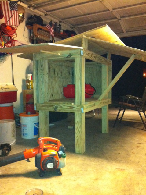

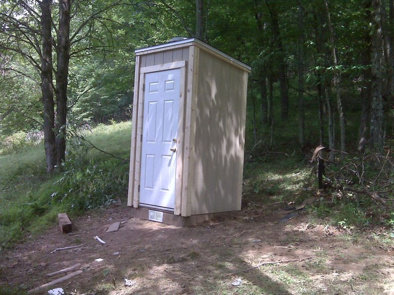

mjmmessina
# Posted: 3 Jun 2013 08:19am - Edited by: mjmmessina
Here is my generator shed, would you think there is a generator inside of it?
