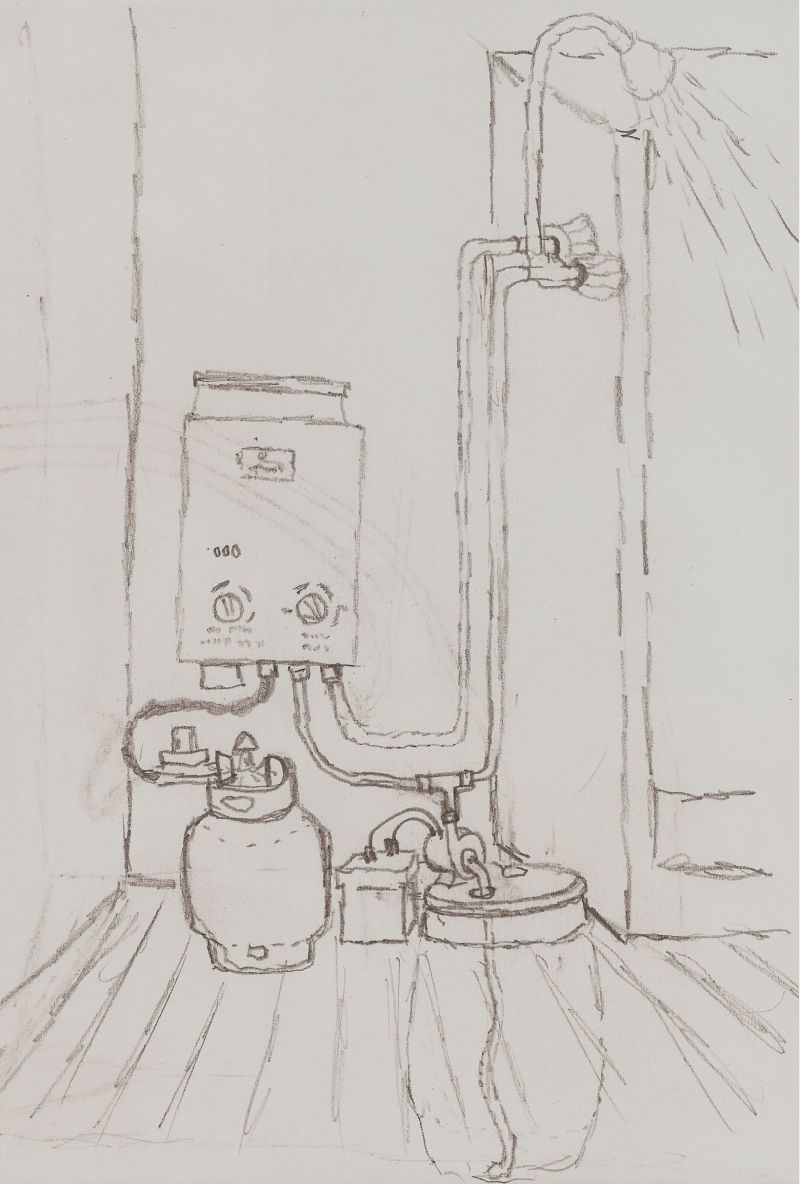

| rayyy Member
 | # Posted: 27 Mar 2013 06:15pm Reply
 Here is a depiction of what I got set up.The barrel shown can be a 5 gallon bucket or a 250 gallon tank.The volume of the holding tank doesn't really matter.The Shurflo 12 volt pump easily self primes and  pull's water from 5 feet below.It claim's it can pull water up from 10 feet below if needed.The pump,s outlet then pushes water over to the eccotemp L5 on demand hot water heater and up to the shower head just fine. If you'd like I could make you a video of the set up?
