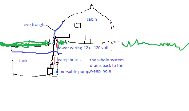

Antler, Can you draw a diagram of that...im not quite following the setup....?? Please!! I am in this stage of driving a well and wanting to pipe it to the cabin to be able to use in winter as well....
# Posted: 1 Oct 2012 09:31pm
maybe something like this
Ill never be a artist

Just...great pic on the fly! LOL I guess I was looking to see how the valves are set up to drain into the waste lines under the sink or other areas....
