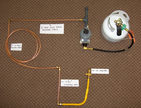

It is a tad intimidating. Attached is the parts diagram I got with our setup from the retailer. They were very good and answered all my silly questions and put everything into a kit. Flaring seems to be one thing that would have been beyond me to do well. They supplied all the copper tubes flared ready for assembly. All I had to do was teflon the screw connections but NOT the flarings.
When it came to the install we had worries about drilling the 4.25" hole through the wall without hitting a stud and too many nails. But we were lucky with our test/pilot holes and it went very smoothly. (Our stud finder was not able to find studs through our cedar and spruce interior wall finishing.) The lady wife and I are still married and we only had one minor blood spatter incident.
There are some odd code laws such as the retailer provided us with 9 feet of copper tubing plus another 2 feet to go around the corner of our shack to be far enough away from the heater exhaust. A few more feet and we would have been back at the heater hole our shack is so small. There are other codes about distances from windows etc. We could not accommodate the latter but open windows and heater on are mutually exclusive events so we are not too worried about that. (We will keep another window open for fresh air on Mexican chilli nights)

# Posted: 5 Sep 2012 05:54pm
Mojo don't forget a regulator. I gather it is not advisable to directly connect most heaters to a propane tank with a plain hose.
We were advised to get a two stage/dual stage regulator compared to the usual single stage one that we use for barbecues.

I have an extra regulator that you hook up to a BBQ. I'll have to read the instructions to find out if that will work. Is a dual stage reg better and safer? I am not even sure what a reg does, but I assume if makes sure that there are no bursts of too much propane sent from the tank?
# Posted: 5 Sep 2012 06:50pm
The regulator drops the high pressure from the tank down to the quite low pressure most grills, etc use. The dual stage regulator drops and controls the pressure in two steps for better pressure and volume control. FYI, the regulator system used on the large home style propane tanks is a two stage. Usually the first stage regulator is on the tank and the second stage regulator may be at the house. That ensures sufficient high volume delivery to all the homes appliances (along with using the right sized pipes).
# Posted: 5 Sep 2012 06:56pm
Note on small tanks (20# and so on). They can not deliver sufficient volume for many high BTU devices, such as large heaters. Many larger heaters require use with a 100# or larger tank. This has to do with the surface area of the propane in the tank; one reason why home tanks are normally horizontal. (But don't try using a tank meant to be vertical on their side.) This becomes more of a problem as the temperatures fall and as the tank level decreases. Also some small regulators may not be able to deliver sufficient volume for some appliances, even with a larger tank.

It sounds like some people have already installed ths unit such as bugs... I was planning to use a flexible gas line. Does this mean that i won't have to deal with flaring?
I just received my package in the mail. The wall installation sounds pretty easy, but hooking it really has no info on hooking it up to a bbq propane tank. Can someone help?
