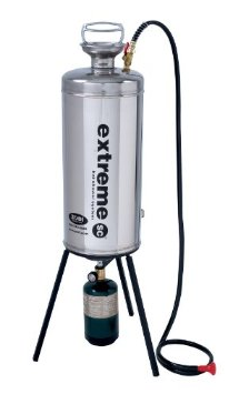

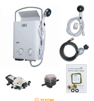

Here's a couple pics of shower systems that might be interesting for cabin-ers.
The Zodi looks like it just heats a pot of water then hand-pump it to pressurize and squirt yourself. If the Zodi is that simple then maybe that's the way to go for hard water? Simplicity has its value. It's pretty easy to ensure that the ZODI is drained for the winter!
To run the L5 without a pump requires a watertank 46 feet above the heater to get the minimum 20psi. (20/.43 = 46) I don't know how to assess whether minerals will be a problem. Probably not suitable for commercial usage with hard water but I bet for cabin-ing you can take a LOT of showers before the boiler gets fouled.
...........I just ordered the L5 as Borrego mentioned! As a kit with a 12v pump and a screen-filter.
Only problem I foresee is I don't know how I'll hide it.....
ZODI Outback system, $155.  Completely self-contained, no wires and easy to drain.
EccoTemp L5 (1.1GPM) and a 12vDC Flojet pump, and screen $175
