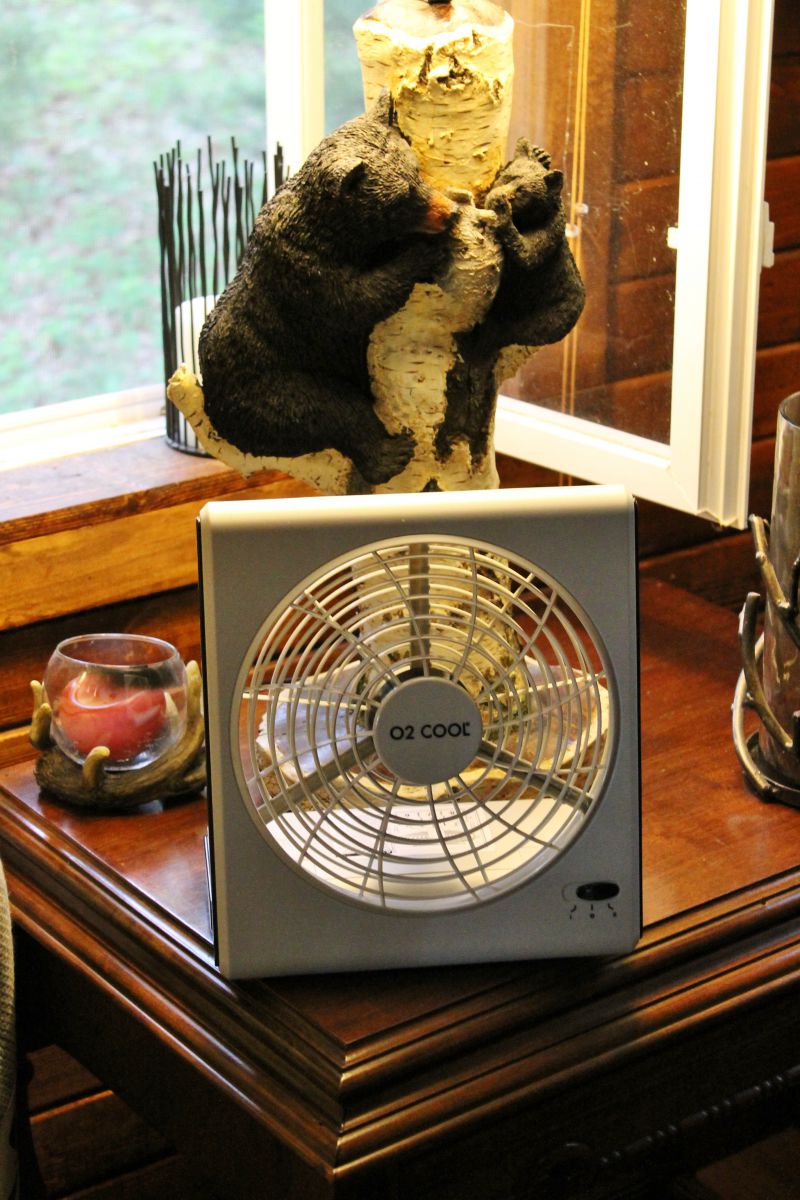

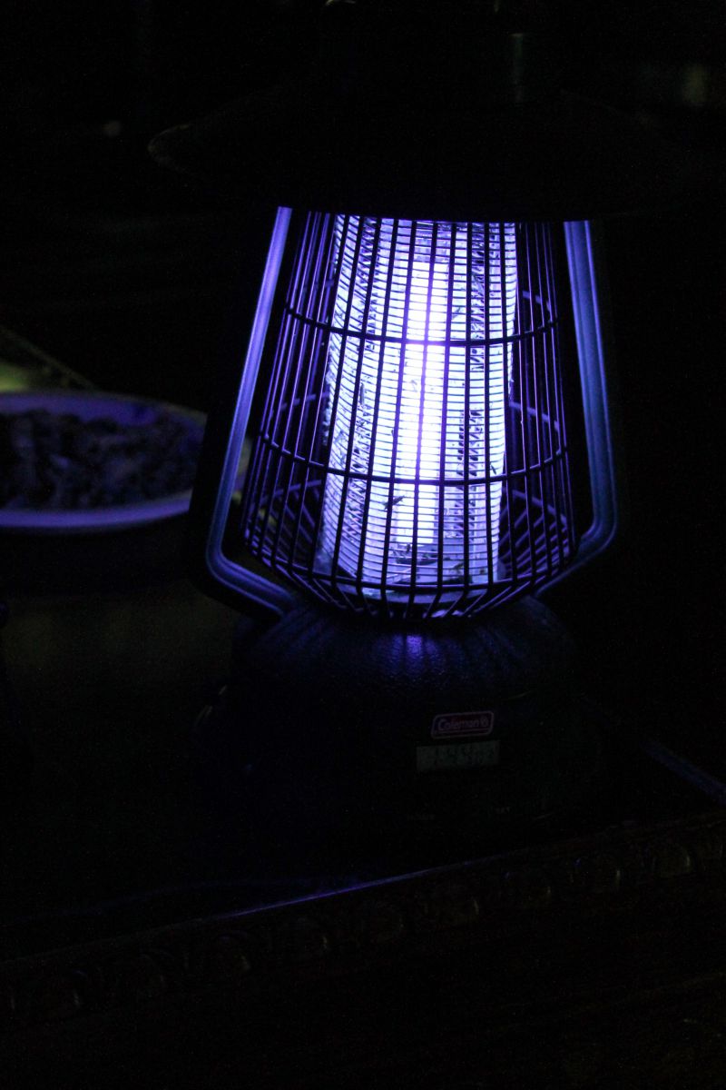

# Posted: 29 May 2012 09:43pm
Its been 90 outside and 80 in the cabin. Although it cools down to upper 60s at night, the cabin doesn't cool down quickly. I found these little fans for $15 at WalMart that will run 80 hours on charged batteries that keep the sleeping area cool. Additionally, Coleman provides a battery powered (rechargeable) bug zapper.
fan
fan
bug zapper
bug zapper
