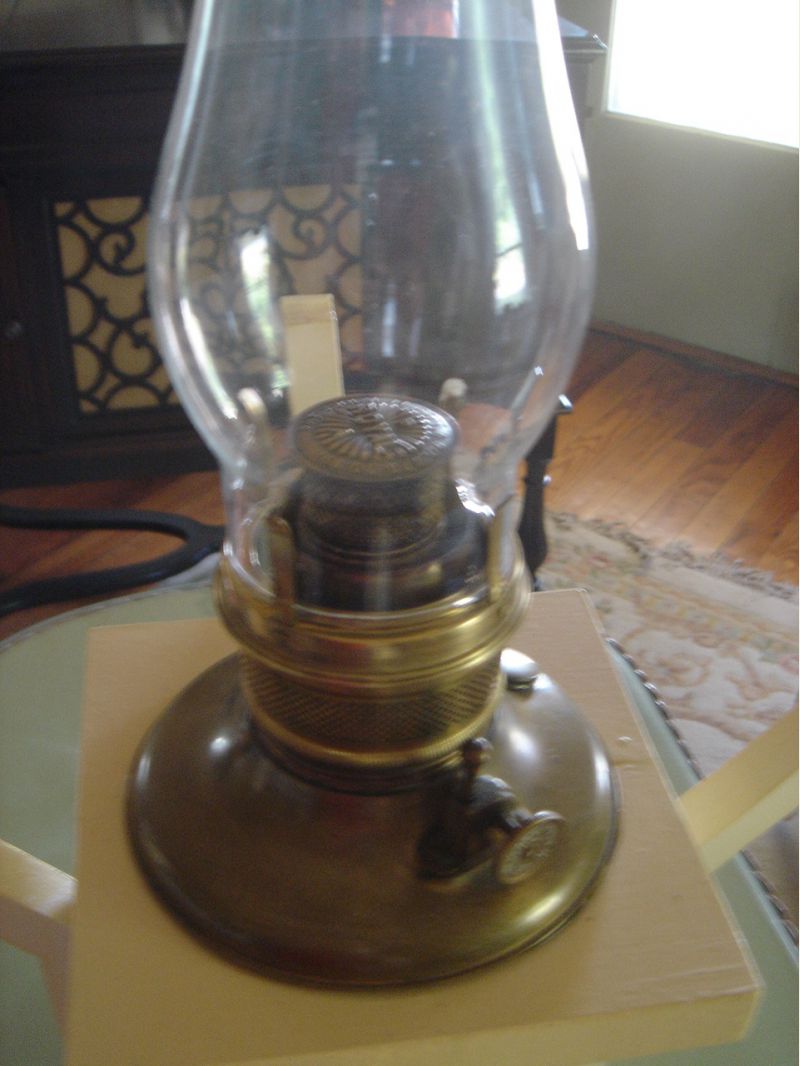

The old Rayo lamps for the round wick are the most common and again not too expensive but a bit harder to tell if everything is alright as the burners can be damaged with time if mishandled. Your going to find flat wick burners that won't turn the wick up since the cogs are shot as well, but they are plentiful and cheap for the most part. When you put a new wick in I find it best to insert the dry wick in the burner from the top and force it down to the cogs with a thin bladed kitchen knife, then when the cogs engage the wick you can lower it sometimes helping it with your fingers till it will become free of the cogs. Often they will not turn up well until you fill the lamp and let it stand a bit as the oil makes the moving of the wick easier. Then you will want to trim the wick off level to the top and I generally snip a tiny bit off each end at a downward angle to let the wick burn higher without the ends wanting to flare upwards ands smoke as some will tend to do.

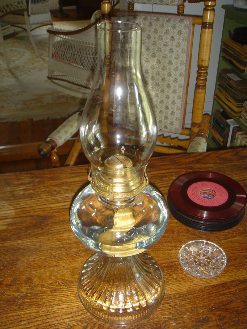

I will put a couple lamp photos on so you can see a few I am currently using.
Larry Older table lamp #2 burner.

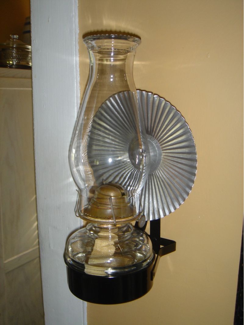

|  Wall or portable reflector lamp.
|  Rayo type burner, shade removed.

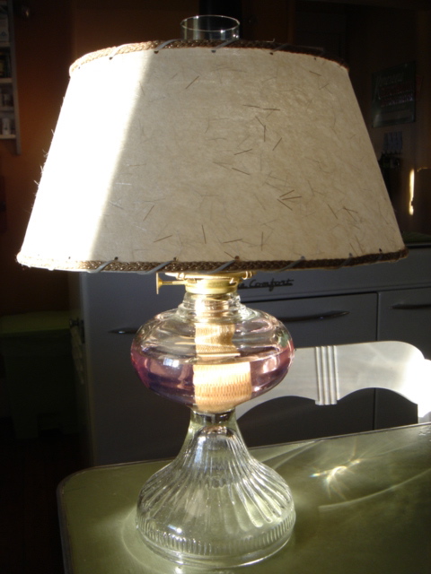

|  Shades I use on some lamps to defuse the light.
