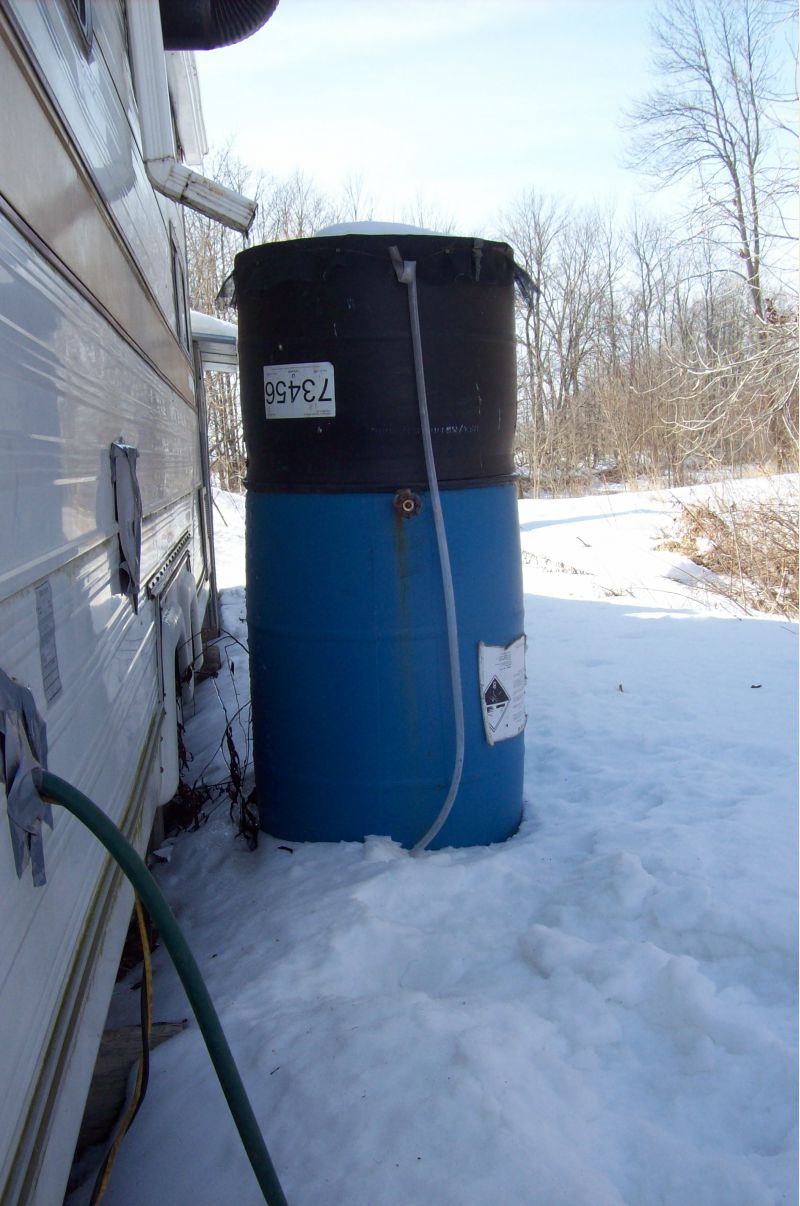

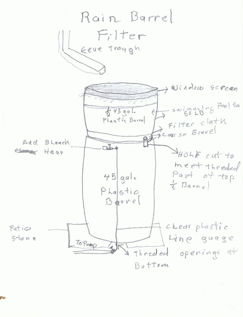

filtered and treated once a week ! if it isn't clean the chlorine will not work. we use it for washing and boil it to drink.

Also a more long term way to treat it would be good cause we aren't always there once a week. How do you filter yours Just?
could set up a drip or a slow release form of chlorine . less often in cool weather. not a problem for me my camp is only 5 m from home.

That is quite the neat setup. Looks a little too much for me though.
I am planning to pail the rain water from the barrel through a 70 micron Tyler sieve followed by a Sawyer water filter and then chlorinate it.
I don't think I want to chlorinate the water in the barrel as it may damage the Sawyer filter.
Maybe if I paint the barrel black or use a black shroud of some sort and reduce the opening to just the size of the down spout it might keep enough light out to keep the algae somewhat under control.
Sounds like I will have to experiment a bit. But most of the whole small cabin process is one big experiment. Part of the fun.

Soooo true! Guess when we get closer we will be doing a lot of trial and error-probably mostly error. HA.
Thanks Just. We will be referring back to your drawing many times I'm sure.
