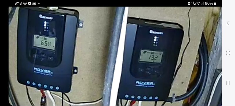

I am fortunate to have internet at the camp. I have a smart plug that I can turn on the lights in the shed and a camera to see the Charge Controllers. One is set to battery voltage and the other to charge current. Here is the current readings
