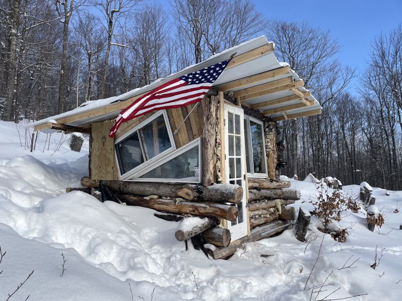

Im new to cabins I built a 10x10 off grid log cabin in Vt. Current having issues heating when I get there if temp is below freezing:
I have a small wood stove that takes a while to warm up. I have 2x buddy heaters that i want to use to warm up faster.
Issue is the propane freezes (i think) i hauled up 2x 25lb grill tanks but those seem to freeze too! I hauled up a brand new one used an adaptor to connect to buddy heater and it was shutting down after 10-20 minutes. It was 10-17f out but thats what im trying to figure out.
Anyway to heat with propane and not have it freeze? Could it be my adaptor or buddy heater? Even if I hike up 1lb camping propane it seems to freeze up after a while (30 min hike then cold cabin). Any ideas suggestions? Am I the only one that seems to have issues with propane freezing and being unreliable? Thanks!

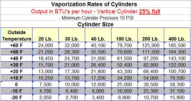

Theres a propane vaporization chart available, let me see if I can find it. With 2 big buddy heaters you may be pulling to many BTU off a single tank.
Tanks will frost up when cold but as long as the propane flow isnt slower it's really not a problem.
You can see by the chart that at 10*f and the tank a 20% it will only output about 10kbtu. I believe that's about what my hunting buddy (single pannel) does.

I like the style of your shelter there. I would look into air sealing things more. You do have alot of mass to heat there with those logs.

The 20# tank should handle one heater, but not two per the chart above... not clear how you have them connected?

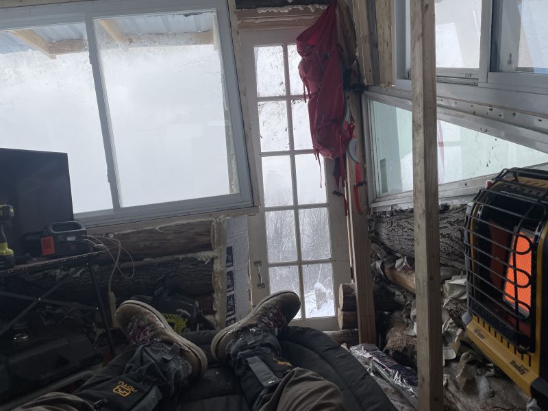

It’s hard to tell from the pictures but it looks like you have some large gaps around the door and can’t tell if your metal roof is insulated. If you seal everything up and insulate the roof your heat load won’t be so high and you won’t need to burn so much LP which in turn will help the tank from freezing up.

Look at the chart I posted above. You will see what they offer over 20-40lb tanks. They do sell 100lb tanks that can be filled on site via truck.
For me its 20lb tanks or 100lb tanks. 20lb tanks because there free to exchange for a new tank then I only pay $10 for a refill. 100lb tanks for bigger draw things, at this point though theres nothing drawing that much.

That table is correct. It was posted here quite a long time ago.
Propane cylinders are filled by the volume (weight) of propane. When the temperature drops the volume contracts. The contraction reduces the propane pressure in the cylinder. The contraction is more noticeable with a 20# cylinder compared to a 100# cylinder.
Combined with the pressure reduction that the colder temperatures cause, the liquid propane evaporates into a gaseous state more slowly. That results in a lesser amount of gaseous propane being available with the smaller-sized containers and lower temperatures. It becomes more pronounced as the volume in the cylinder falls.
Not that is makes a lot of difference a 100# cylinder is about 2 inches greater in diameter than a 20# cylinder. That increases the surface area inside the 100# cylinder by approx a third. That helps too.
