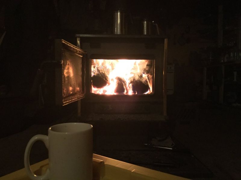

I've only been burning wood for 40 years or so but my advice is to use the fresh air intake vent control to manage the intake air. I don't have fresh air from outside coming in as I don't feel that the fire consumes that much air.
And having a hot fire may cost an extra piece of firewood but your stove n pipes should be built to handle any temperatures. Not burning a hot fire can give trouble. Frankly speaking I purposely burn hot fires to keep the creosote from building up.
I also like to have the door open n use as a fireplace. My stove has a screen that fit over the front of the firebox to catch sparks. I've learned to put the bark to the back helps. We have a glass door that allows us to see the fire but I generally just leave the door open n watch the movie.
I also like to use the largest piece of wood that will fit through the door for overnight. Then fill in gaps with smaller split wood. And a lot less wood splitting.
I really enjoy wood stoves n each one has their own intricacies. You will figure it out. And if you're stove instalation is correct and pipes in good condition you should be worry free.
Because it hasn't been written the type of wood you use matters a bunch. Heavy more dense woods burn longer and can burn hotter. During the day if you're just perking along only add smaller amounts or smaller pieces of wood. At night load er up n close down the damper.
With the blaze king I keep going in our 20x24 garage I can start a fire n then load er up. Shut down the damper. And I don't have to look at until the next day. Been keeping the garage above 50 degrees while it been in the minus 15-20s.
Every once in a while it will take off. And get hot. Kinda feels like a stress test but its nice knowing you're equipment is up to par. I prefer stainless steel pipe as it doesn't rust and stronger.
Also I have a bag of fire retardant for wood stove chimney fires close by.
You will get used to it and should not have to worry too much but always respect it.
Good luck n have fun
