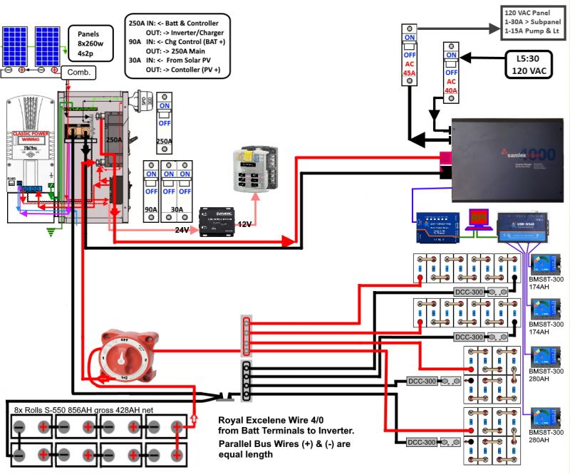

Here is my Solar System (Last revision picture, out of date now) with 5 LFP(LiFePO4) Battery Packs in Parallel (CANNOT LINK IMAGE, So posted as Attachment.)
Solar System DEC(2020)
