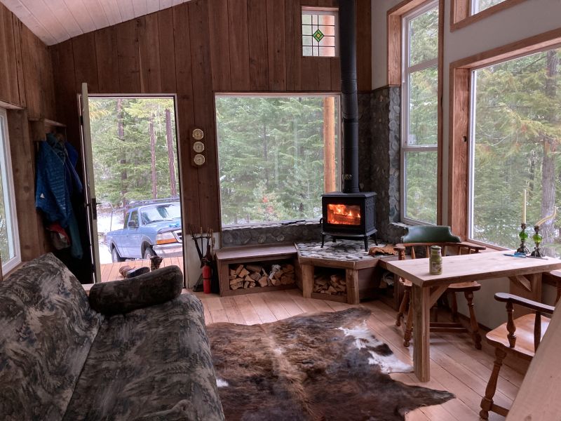

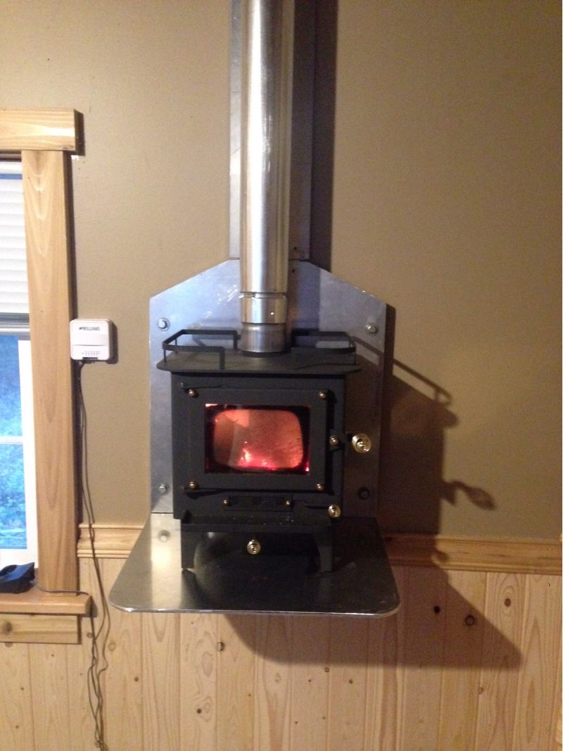

I use the Grizzly model from Cubic Mini for my 12 x 12 bunkie. We could not be happier with the performance from it. Sure it won't burn through the night but we get it nice and warm in the loft before bed and it stayg pretty good until morning. Mounted on the wall so easy to load. I built a mount out of 1/4" aluminum spaced off the wall by 1". See picture.

Quoting: Al Burton
Al, what an adorable little woodstove. Very nice clean install too.

Quoting: toyota_mdt_tech

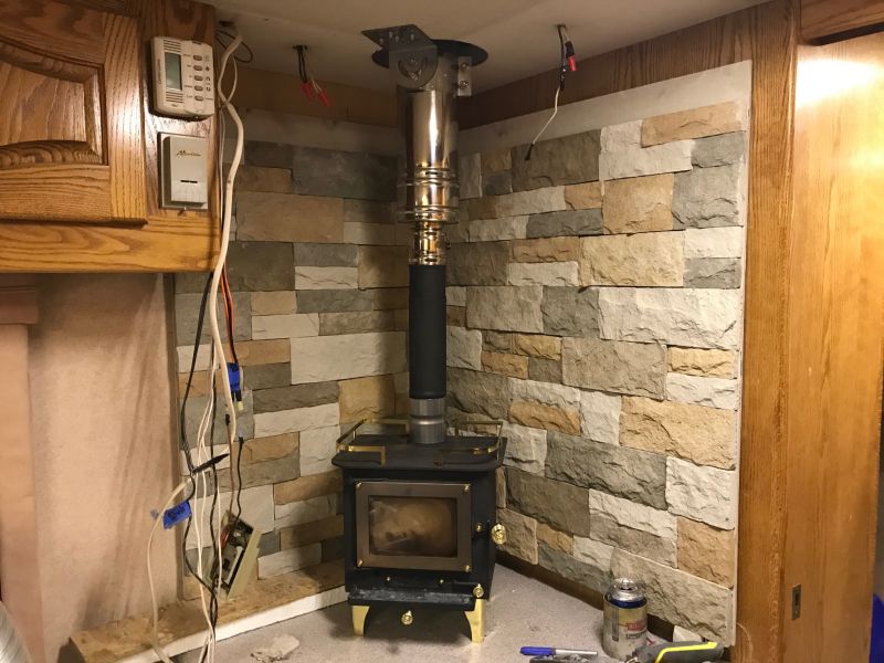

Thanks Toyota! Here is another that is not quite finished but usable. This is in a Monaco bus that my brother lives in up here in Canada. He loves it and thinks it is the best change he has made to his bus. I will finish trimming the top and add some down lighting etc.
# Posted: 30 Jan 2021 09:09pm
Al, it looks like a large woodstove in the corner of a cabin, then when you see the beer can, it puts it all into perspective and you realize how small it is. Those look like those woodstoves you see in small boats.

Good observation! Lots of people are putting these in boats and rv's now. We removed a seldom used liquor cabinet. I think this model is rated at 8000-18000 btu/h so not too bad. It is a true airtight with secondary combustion and the option of fresh air intake.

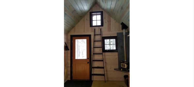

Here is my Grizzly. It sit on a shelf in the corner covered with cement board and tiles I made. That by itself is not ideal because there is no standoff, so I also put up metal sheets (they are cookie sheets) when it is actually burning.
Grizzly in 10x16 cabin

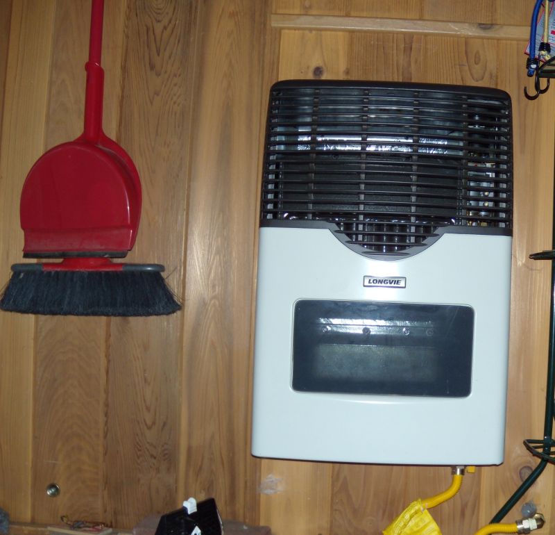

It really depends on the wood but I think I get heat for 3 hours at least once it if fully up to temperature. If you notice in the first picture the thermostat for my direct vent wall heater is right beside the stove. That way the heat will kick in when the stove stops throwing any heat.

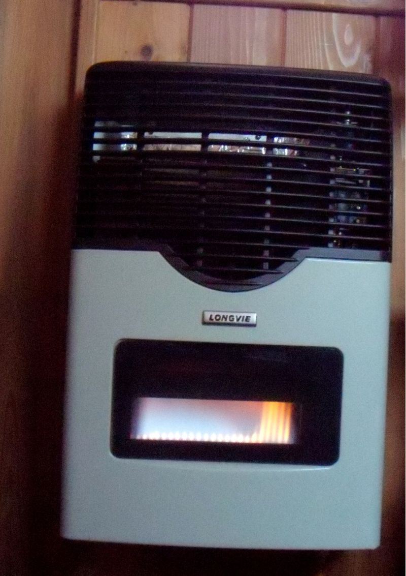

jmccartney101: Good Luck with your project. We had the same problem regarding heating our 90 square foot mini cabin to extend our visits into the early spring and late autumn. As you can appreciate space is at a premium. Every inch counts! When we looked at options ie mini wood stove, buddy propane heaters there were serious issues. A wood stove has to have proper spacing around it and behind it so that choice was out. Buddy heaters are out as they are not intended for use in enclosed spaces (H20 issues and CO issues as mentioned). So we went with an RV type propane wall mounted vented heater. Works really well. Cheap to use and takes up very little space. Just my thoughts.

# Posted: 3 Feb 2021 06:39pm
offgrididaho: I did it myself. The company I bought the stove from (2 provinces away) provided all the bits ready to assemble (pipes, regulator, fittings) and I just followed their instructions. Likely not "proper" but there ain't much "proper" at our shack in the woods. The scariest thing was cutting the vent hole in the wall.

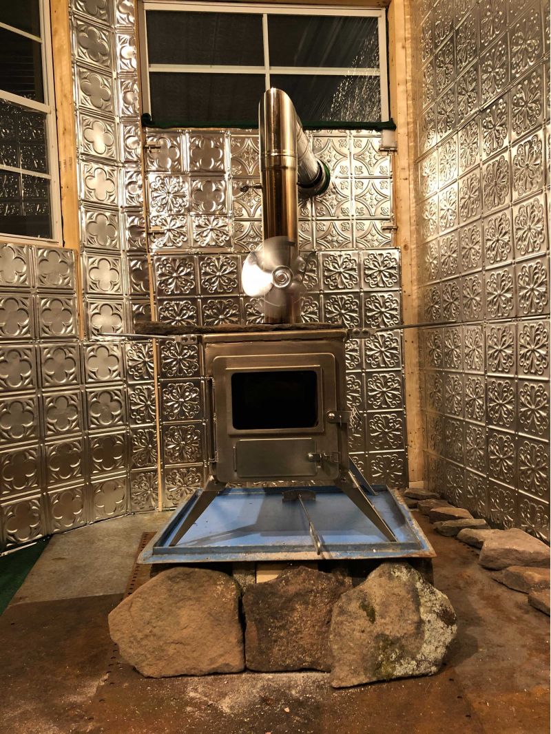

I recently bought and installed a Winnerwell tent stove in my barn/studio. It's been kind of a mad experiment, but it mostly paid off.
These tent stoves are great because they are light enough to move around easily and you can buy extra chimney pipes online. The appealing thing in general was being able to order the whole set online, rather than having to hunt down a nice heavy cast iron stove along with the chimney parts. I just didn't have a lot of time to install it (as much as I really want a nice cast iron stove).
I wound up using ceiling tiles for the surrounding walls and ceiling area, which is a bit nutty but it works well. Not up to code though.
The chimney does have a few angles as it snakes out of what was the lower window, through a proper silicone boot.
The major downside, as people mentioned, is the chimney draw — the pipes are only 3.5" diameter, and I am using a lot of them, at angles. So the stove sometimes struggles for air, and then when you open the door a rush of smoke comes out. This is the main problem — but, that being said, it still works well. The angled pipe inside is actually nice because it acts like a large heater in itself.
I blocked off half of my barn space with a curtain, so heating the remaining 200 sq. ft. isn't too difficult. The other night the temp. inside was 24°F, and once I got the fire going and the smoke out the window it got up to 63°, all in about 45 minutes. Not bad at all. And the space is not insulated at all. The amount of heat pumping out of a small stove like this is really impressive. The pipe glows red — it gets up to around 600°F. It easily beats my vintage Franklin wood stove I have in my cabin.
These portable stoves are great for fairly fast DIY installation in a small shed or shop. But the smoke / draw issue is a minor problem.

Do they have 45* elbows? If so and you used one near the stove outlet and another near the wall exit you would have an angled pipe between and improve the draft from that 90* and a mostly horizontal run, maybe by a lot.
justins7
# Posted: 4 Feb 2021 06:16pm
gcrank1, They do make 45-deg sections, which I have. But the problem is that the pipe goes outside through the lower part of the window — and it's too low to be able to have two sections of 45-degrees. I really need to either cut some of the pipes or really try to go through a different, higher section of wall. But with temps dipping into the single digits I have just left it as-is for now.
