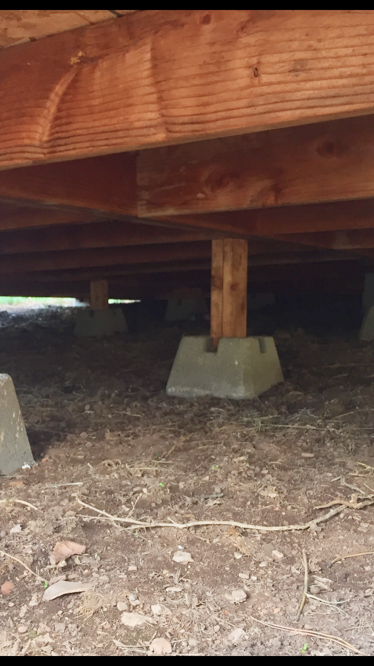

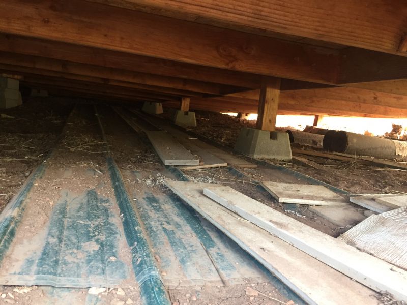

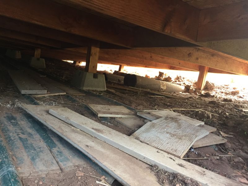

So hubby and I recently bought a 10 year old 24’ x 28’ cabin on some land in Northeastern Wyoming. We plan to live there offgrid eventually but as of right now its an empty shell.
The most concerning thing to me is the “foundation†which is made up of treated lumber and deck blocks(pics included below). The subfloor inside is pretty water damaged/warped and needs ripped up but I’m fairly certain some of the beams have settled as well. Some construction buddies told me to jack and shim it but I’m worried about further settling once we start to build. I’m not sure how much weight the current “foundation†can support.
What would be the best way to sure it up? Concrete sonotubes? Concrete blocks? It gets very cold there. -50 being the coldest according to the neighbors, so we’d have to dig down like 6’+ if we went the concrete pillar route lol But I’m willing to go the extra mile just to know it’s going to be solid for the future.
I’ve also done some research into shallow frost protected foundations. Does anyone know anything about them? I know they’re typically done with monolithic foundations but I’m thinking mayyyybbe I could achieve the same effect with insulation and concrete blocks....??

# Posted: 11 Jun 2020 11:28am
Another poor start to a nice cabin. Since the floor needs to be ripped up take it up and put sono tubes in from the inside on real girters and posts, 4x4s are to small.

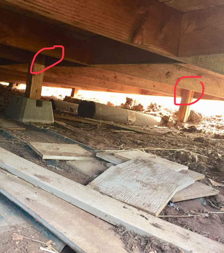

# Posted: 11 Jun 2020 11:00pm
Quoting: Brettny Another poor start to a nice cabin. Since the floor needs to be ripped up take it up and put sono tubes in from the inside on real girders and posts, 4x4s are to small
And it looks like the 4X4's are screwed to the side of the rim joist vs being under it. Means load of entire cabin is going through some screws. Or am I looking at it wrong?
Princelake
# Posted: 12 Jun 2020 06:56am
Ya that's what I noticed to! With movement those 4x4s will bust through the floor! Are there any actual beams?
# Posted: 12 Jun 2020 08:20am - Edited by: Brettny
Wow 2x6 floor joists cant span much. Tell me there at least 16in on center? With 2x6 floor joists your really going to need a girter about every 4-5ft across the 24, way to make a solid floor.
Your going to have a hell of a time fixing this properly. With the amount of work I'm seeing here I would have bought this cabin with the intentions of useing the roofing and possibly saving the walls. Build a better foundation next to it and tearing this down is how I would do it.
Ladyfox
# Posted: 12 Jun 2020 08:21am - Edited by: Ladyfox
Quoting: toyota_mdt_tech And it looks like the 4X4's are screwed to the side of the rim joist vs being under it. Means load of entire cabin is going through some screws. Or am I looking at it wrong?
Quoting: Princelake Ya that's what I noticed to! With movement those 4x4s will bust through the floor! Are there any actual beams?
I think you're both right! Wow. I thought it was an optical illusion at first but some of the 4x4s definitely don't look like they're positioned correctly. I can't believe I didn't notice it before.
So can I even rip the floor up without the place collapsing on me?  ABBF85A50CC143528.png

# Posted: 12 Jun 2020 08:56am - Edited by: Brettny
If my math is correct you will need about 7 girters 28ft long. The taller you make these the less sono tubes you will need. With the cabin being so low to th ground I dont see an easy way to dig for a sono tube.
Was this cabin looked at by someone that builds like an inspector or friend with knowledge prior to paying for this property?
In all reality I may be easier to build a proper foundation next to it with new 2x12 floor joists and 3/4in sub floor then drag the cabin onto the new foundation. Then you could take away the 2x6 floor joists. Either way it's an enormous amount of work to save 4 walls and a roof. Some of which you could take down and re arrect anyway.

I'm trying to think how you can do this and not tear the whole thing down. If you have a truss roof I think I'd replace both sides(one side at a time) with a Sono tubes and beams. Then you can probably completely cut out the plywood and 2x6 joist floor. Then it'd be wide open and inside dig for new Sono tubes and beams. Then reframe the floor and put new plywood down.
