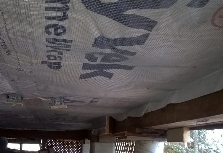

# Posted: 12 Feb 2020 08:47pm - Edited by: rpe
We insulated our floor with R30 Rockwool, stapled over with Tyvek to hold it all snug. Then we followed up with 1/4" mesh galvanized wire cloth to keep the critters out. We are on the second winter, and so far we are critter-free.
