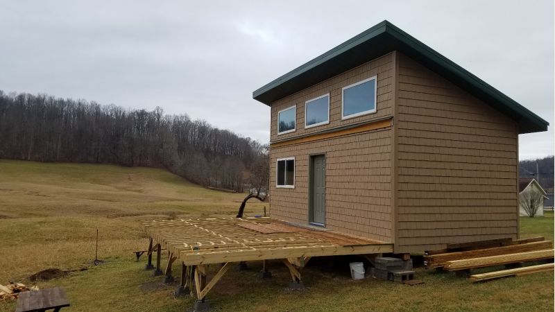

First time builder here constructing a 13’x23′ shed roof cabin with my dad in central West Virginia. Three weeks ago I had 2″ of closed cell spray foam installed in the walls/floor and 3″ in the ceiling. Walls are 2×6 and floor joists/roof rafters 2×10. I keep the place open as much as possible to allow for ventilation.
I recently started spending more time inside with a electric heater running and notice a slight paint/chemical smell. If inside for 30-60 minutes I can feel it in my throat/lungs, like when you use a strong cleaner without good ventilation.
The installer came out said the mix looks good and cannot detect any odor but wants to put 6 mil poly on the walls and ceiling. No core samples were taken. He thinks I'm just sensitive to the foam.
