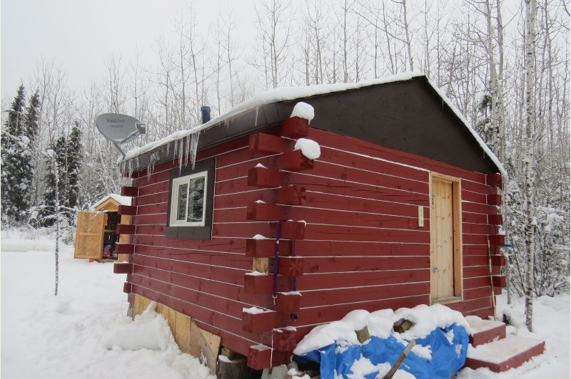

Reply Quote
6†should be good. We have 6†, 3 sided logs. Warms up real nice. And we use it more in the winter than in summer. And it gets warm fast. And stays warm. In Ak.

Reply Quote
Mine heats up in less than an hour and stays almost too hot, but it does get cold quickly without a fire burning.......
