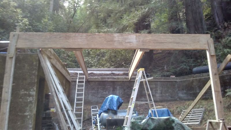

I'm commencing building a carport on this old concrete structure on my property. It's an interesting story I'll explain later and post better photos. My plan is a plywood roof with tar or torch down, mild slope, no snow.
I salvaged 30+ of these engineered joists, and a half dozen parallam beams out of a warehouse demo a few years ago with this in mind. They are 18" high, the span will be 20'.
It will not be enclosed. It's in dense forest, very damp winters with little to no sun. I'm concerned about the durability of these joists. I have 20' 2x12 regular boards I could use instead but that leaves me with the I-joists. What do you think?

Thanks rockies, we'll I guess I'll see, started laying it out today. I did some reading too, they are used a lot in above ground flooring, as long as you keep them from getting wet they seem to do OK. The main thing I realized is that I have stored them for two or three winters stacked right on this concrete under a tarp and they haven't suffered. Can't imagine it will be any worse in use. I have agonized for over a week on using them or not. See those 4 ladders? Bet I went up every one a dozen times today.
