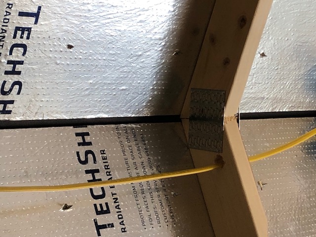

Planing out the roof insulation process for our sheds.
The roof is metal over Techsheild osb ( it has a foil face on inside) on 2x6 rafters. At the wall end, it is just boxed in- no air vent in the soffits. It has a ridge vent and gable vents. The plan is to use 2" polyiso foam between 2x6 with air gap to the Tech shield. Put thick black plastic to inside for vapor barrier and the T&G over plastic.
My question is do I need to put vents in the soffits in each bay between rafters?
Photo of soffit area from inside:

I may not be fully understanding your situation but the concept behind venting from sofit to either ridge vent or some sort of roof cap is to encourage a natural flow of air using the principle of warm air rising. As the air within the pocket created by the 2x6 and sheathing warms up it wants to rise. You need an exit for this as well as an entrance for replacement air, which would be cooler.
If you are using 2x6s for rafters and placing 2" insulation between them, how are you installing the 2" insulation?
I would find a way to keep the insulation flush with the insides of the rafters and create an air pocket between the insulation and the roof sheathing. Then vent the soffits so air can flow from the bottom of the roof to the top and out.

Quoting: Wilbour I would find a way to keep the insulation flush with the insides of the rafters and create an air pocket between the insulation and the roof sheathing. Then vent the soffits so air can flow from the bottom of the roof to the top and out.
That is my plan. The foam board polyiso will be flush to the inside of the 2x6 leaving air gap between roof deck and insulation.It will be a friction fit. But without it having soffit vents it does no good in my mind. Not sure why they built it like that. I think a 2-3" round screened vent in each rafter bay would be enough. Cut hole with drill and hole saw bit, caulk around vent edge, pop into place.
The TechShield says directly on it not to let insulation touch it, lol

Your ridge vent will have a spec on lower end venting. Follow it.

Quoting: mj1angier My question is do I need to put vents in the soffits in each bay between rafters?
Yes, you do. Your plan for using a hole saw and the pop-in vents will work, you just need to make sure you are allowing for enough venting.

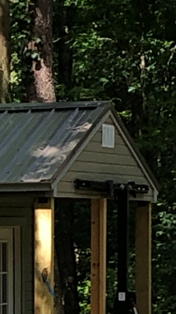

So I am in North Carolina foothills- pretty much the poster child for hot and humid... This is what ridge cap looks like and what inside looks like at it
