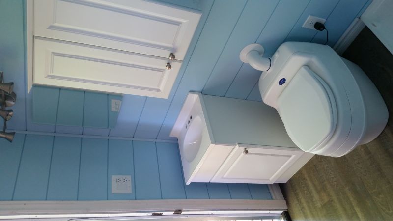

# Posted: 29 Jun 2019 08:46pm - Edited by: Absolutely
I just finished a stand-alone bathroom in mdf shiplap from Home Depot. It was pre-primed so two coats of latex covered it nicely. If it was unfinished wood I would prime it first with zinnser. I like the look and I was trying to get a Bahamian vibe.

# Posted: 30 Jun 2019 01:05pm
That blue shiplap bathroom is very nice, definitely more beach house than cabin in the woods.
