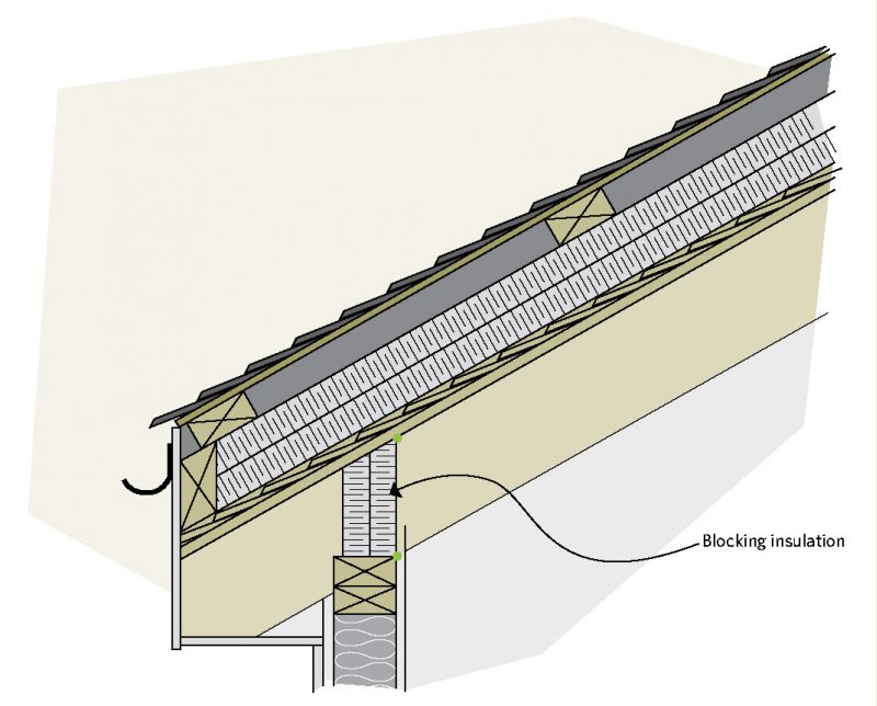

# Posted: 5 Mar 2019 07:34pm - Edited by: rockies
ICC: Kitty probably wants to have a loft.
I agree that doubling up the rafters will do nothing to increase the amount of insulation but at 3 1/2" of depth you'll only have enough room for 2" of insulation (leaving you a 1 1/2" deep vent channel - which isn't really enough). With all the baffles, insulation, eave and ridge vents needed it's all a bit overkill for such a thin roof.
I suggest using an exterior insulation board. On top of the sheathing put a layer of 30 lb felt paper, then the rigid insulation board, sleepers, a 2nd layer of sheathing and then your roofing. The inside of the cabin roof can be left open or finished with a ceiling, but you won't have to worry about vents, air channels or moisture buildup in the roof cavities.

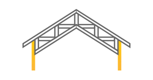

# Posted: 5 Mar 2019 08:02pm
R40 batt insulation 4 in. Ventilation cavity,works for me .
My homes truss system!
