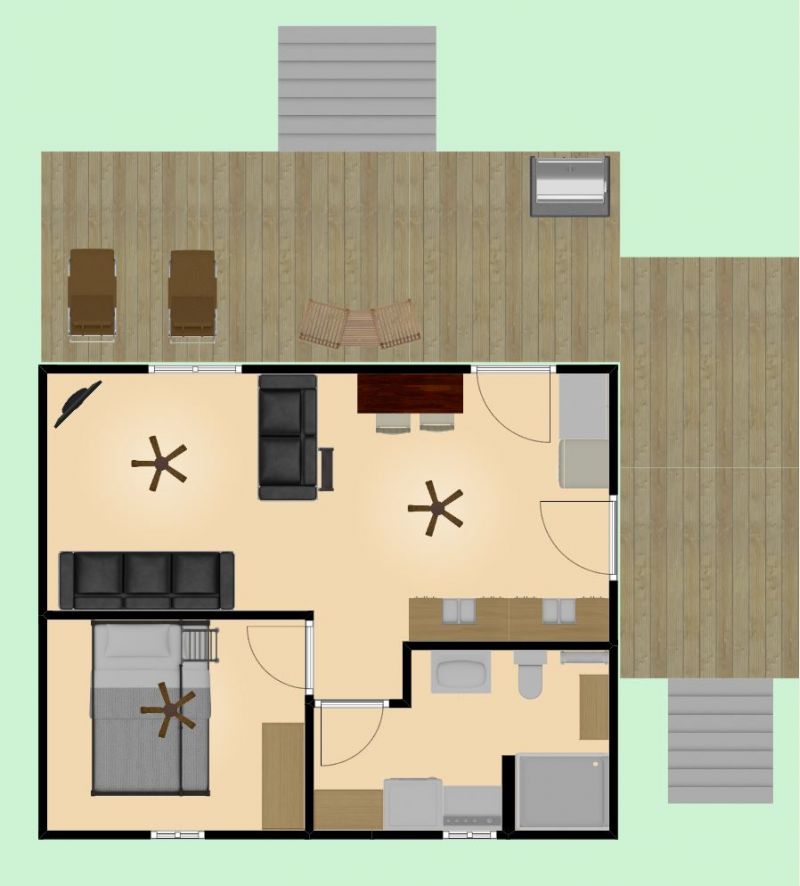

Like Borrego said, design it yourself.
I used floorplanner.com. Lets you draw out walls, color the interior, and drop in furniture. Size everything like you want. I used this on our cabin to help both of us visualize everything. Then went with some light cad work to pattern out studs, ceiling joists, rafters, etc....
One design per account in floorplanner is free.
Attached is an early concept of what we did. You can draw in multiple layers for basements, lofts, etc...
We also used it for our home a few years back. Just drew out the floor plan and our contractor took it from there. We live in a very rural county in the lower US and permits / stamped drawings / etc.. are not required.
