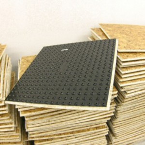

A plastic bubble wrap product would not be my first choice since it still allows moisture to become trapped under the plastic. All that moisture has to go somewhere and the quicker it evaporates the better.
The other thing I suspect is that you have a cold floor which is uncomfortable to walk on. A better choice would be a product like "Drycore" which creates an air channel under the osb subfloor to allow the concrete to dry. You also get a much warmer finished floor and the rigid plastic dimples and osb surface will give you a firmer feeling floor when you walk on it (you'll always have some flex with bubble wrap under a laminate finished floor).
http://dricore.com/nw/index.php
slatecreek
# Posted: 31 Jul 2018 10:11pm
The dry lock is the same product only with an osb backer board. This DMX product is not a bubble wrap but a hard plastic dimpled sheet in roll form. They claim the DMX AG is better than dry lock because there is less seams and they provide sealing tape for the seams. In my opinion they both have the same issue, sealing the product to the wall and trapping moisture underneath. Cold floors yes, but we have a few fiber mesh rugs and slippers to solve that until the wood stove warms up.

One thing to remember is if you vent out you must vent in as well. The drycore idea may work at keeping the furniture dry from the condensation forming. I suspect this is your main issue. Perhaps a vapour barrier on the concrete and drycore on that?
My issue is what happens to the water trapped under the false floor?
Perhaps you vent it around the perimeter?

You don't want a plastic vapor barrier on top of the concrete, that will just create a pool of water under it.
If you do use Drycore or a similar product keep it about an inch away from the walls.
