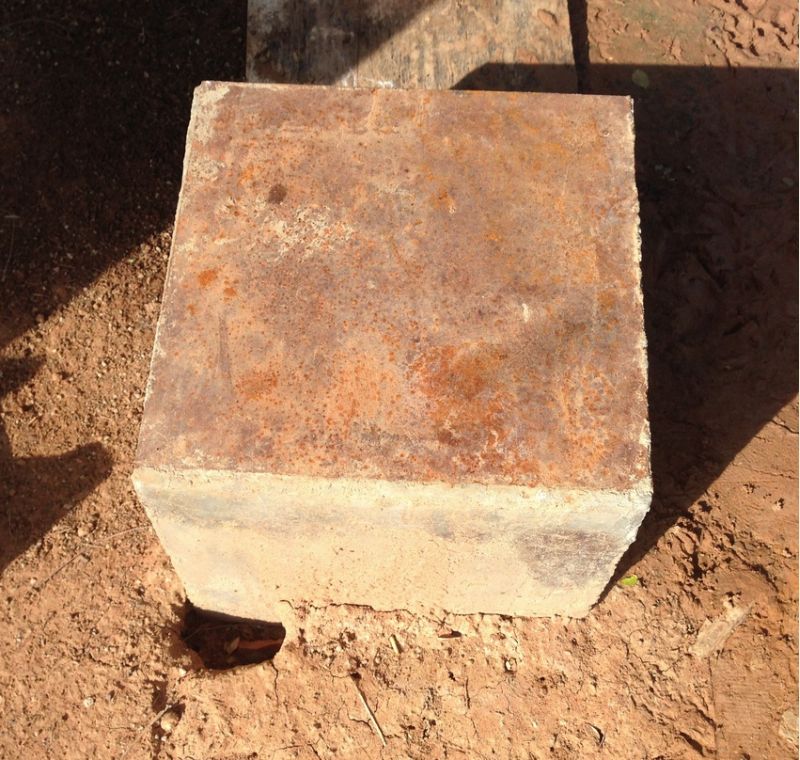

We don't have tubes like that here in Cambodia, unfortunately. What I do here is, form up a column to pour for a footing. Wood is used for the form.
I take the dimensions required for the project, and have flat plates (thickness varies depending on project size) cut slightly smaller than the final exterior dimensions for the columns. I then have pieces of rebar (diameter varies depending on project size) bent into the shape of an "L" and have the long side welded to the bottom of the plates.
After pouring the columns, we insert the plates until they are flush and level with the top of the concrete. We can then weld anything we wish, to those plates.
Below, I will attach a photo of my latest poured column, formed and poured to support a small tower on which to mount antennas, at a height of 7 to 8 meters (~23' to ~26' 3").
The column is 30 cm x 30 cm (~12" x 12") each side, 60 cm (~23.5") deep, and 51 cm x 51 cm (~20" x 20") wide at the base, which is 10 cm (~4") high (thick).
I have no idea if this would, or would not meet "code" in the US, Canada, or elsewhere. Here in Cambodia, they wouldn't know what even "code" is.
