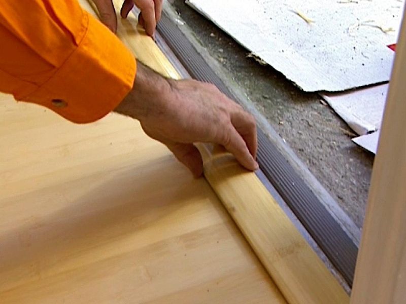

No, you just need to install the door...period. Put down some flashing and silicone it good. The floor will work with it....
Something like this, I've used it before. https://www.lumberliquidators.com/ll/c/Premium-Underlayment-Sq-Ft-BELLAWOOD-BELLAPREM /10023615?Wt.ps_id=PS_google_1023&cagpspn=pla&CAWELAID=1925959333&CAAGID=42480250059& CATCI=pla-294930372950&CATARGETID=420003430000674489&cadevice=c&gclid=CjwKCAjw_47YBRB xEiwAYuKdw9b20CG_cWBh2IxHsq9Q-vQclLYD7aIlPhjepC4iIUa3y-XPTRcJuhoCJNwQAvD_BwE
You can find similar at the big box stores....just don't cheap out on this....

Cool. What's the reason to not cheap out? Does it compress unevenly out over time?
Is that trim pictured in your post above a piece that goes with the flooring? I've seen those stacked up in the Pergo aisle at Home Depot. Or is it wood, like the trim I'm using around the door?
