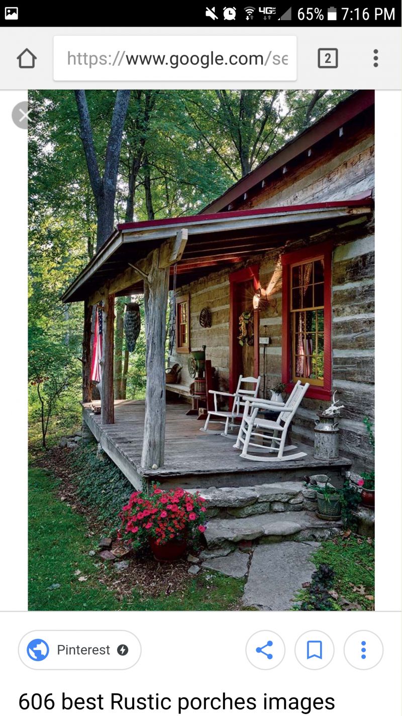

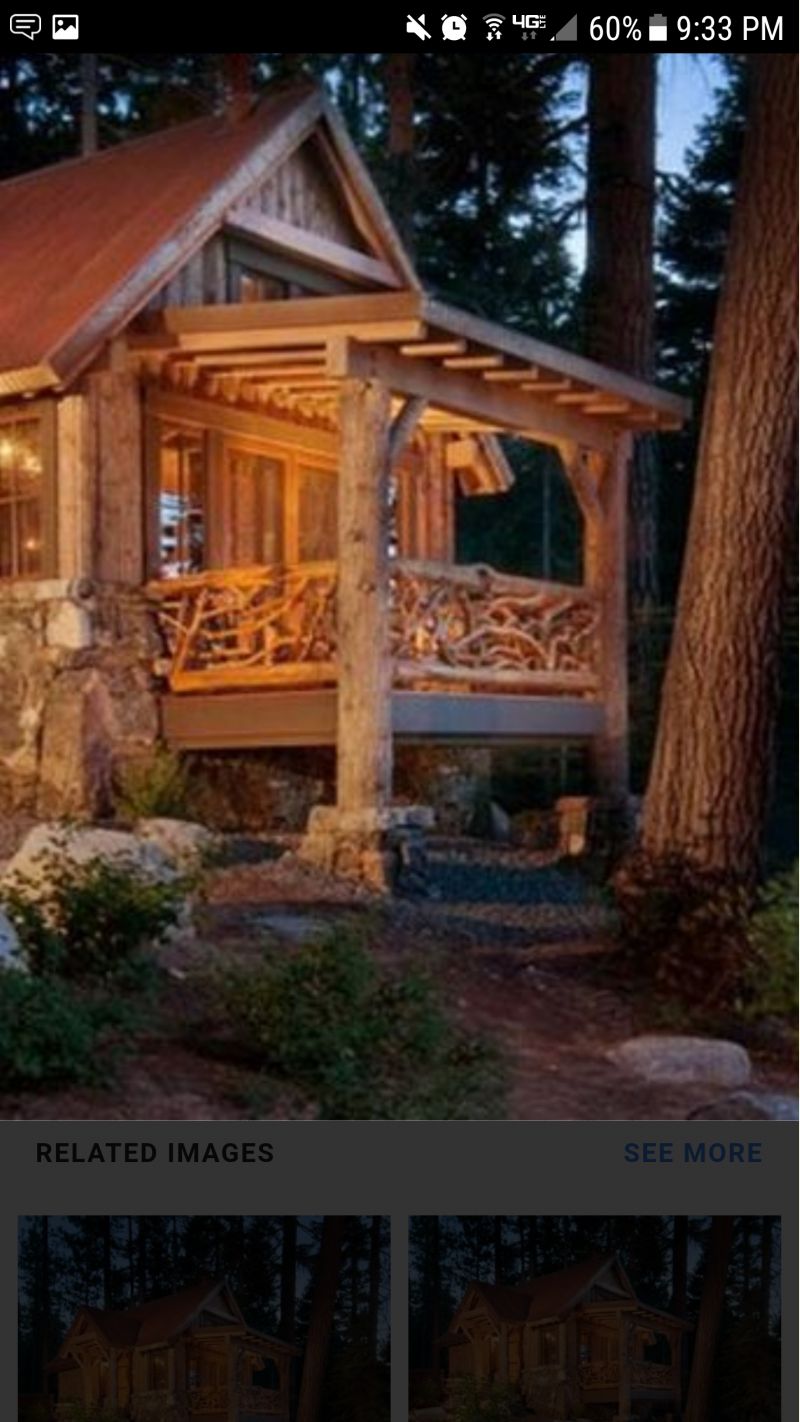

# Posted: 16 Apr 2018 07:14pm
Just something i liked.

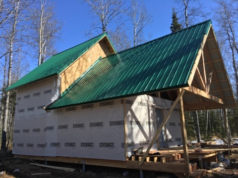

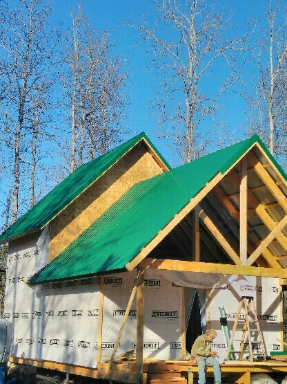

# Posted: 28 Apr 2018 07:28pm
My thinking is that it's OK as long as you get the load transferred to the ground and get it anchored down but just my opinion. That's how I did mine in AK, pics not the best but shows the concept.
I'm pretty much making it up as I go so some of my thinking is happening after the fact.
