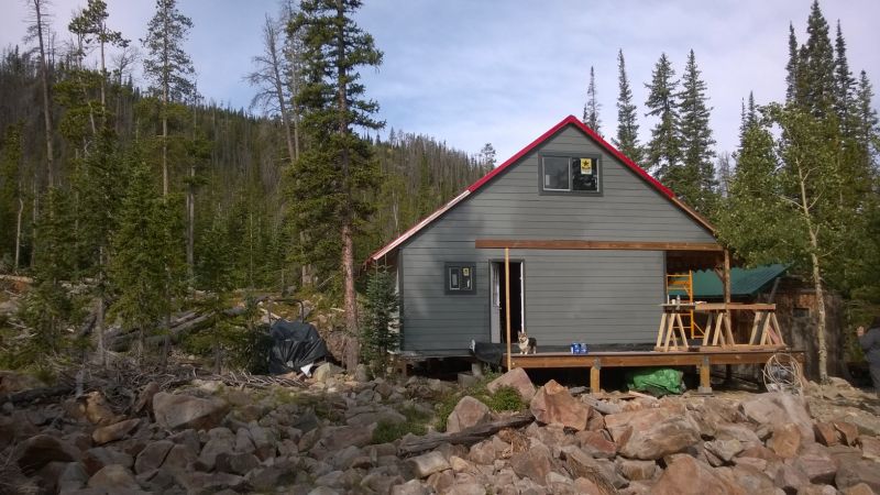

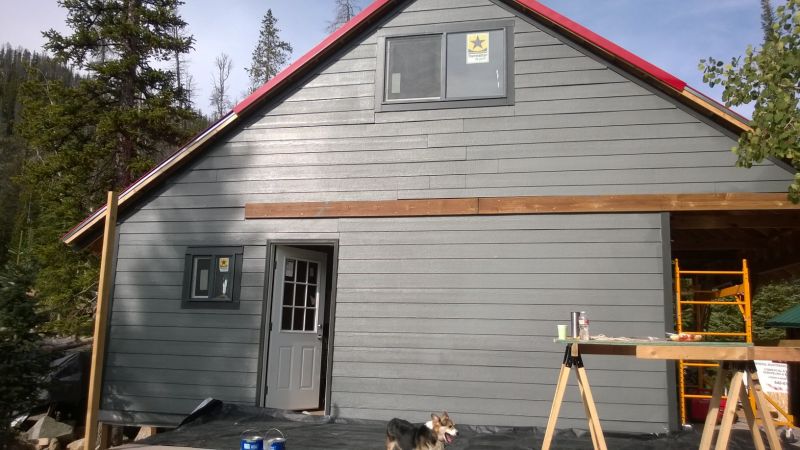

Sherwin Williams makes some great weather resistant paint with UV inhibitors. Not cheap, but I don't want to do it again soon. I just painted the back side of my cabin this weekend with the stuff, you can see the cans in the pictures. Now granted, I opted to use a cement siding due to the a number of factors, but I expect it to last at least 10-15 years. Back_Siding_close_up.jpg

justins7
# Posted: 15 Aug 2017 11:44am
Nice job! Was it water- or oil-based paint?
snobdds
# Posted: 15 Aug 2017 12:15pm
It was a acrylic latex based paint, no oil in it.
I have gotten away from oil based paint due to them never hardening anymore. Part of making them less VOCC, requires them to take out the hardening agents. The paint then stays somewhat tacky and soft.
I actually put a small amount of automotive paint hardener in all my latex paints to give the paint a super hard surface. The hardener does not work in oil based paint, just so you know.
