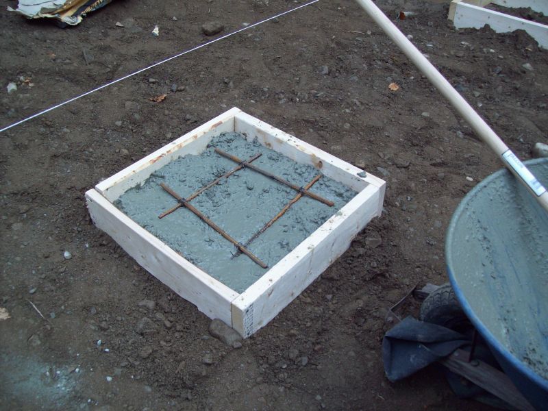

Just build 2'x2' 6" deep concrete pads like in the picture. You can build them right on the existing ground. I built my camp (24x32). two sheds 12x14 and a 3 storey 8x12 water tower on them. Have had no problems at all with them - and we have lost of frost and moisture up here in New Brunswick. I used PT 2x6 laminated for the posts and beams so will have no issue with rot there. The pic shows one of the pads for the main building - had a pad built for it - big side hill. I fill the pads half full then put in some rebar. My son and I put the 15 pads down for the main camp, mixing on site, in less than four hours.

Sounds good Jim, About how many pads would I need for a 12'x12' cabin?

You would only need four pads if that is the method you are going to use. The pads "Just" talks about would be heavy - you would need to be able to place them from a vehicle very close to their final resting spot. I had fun with making the pads.

Your'e talking 4-2'x2' 6" deep concrete pads Jim?

Yes - that is what I have used. Will also use it for a sauna I am going to build this summer and storage/bunky on another property on the ocean.

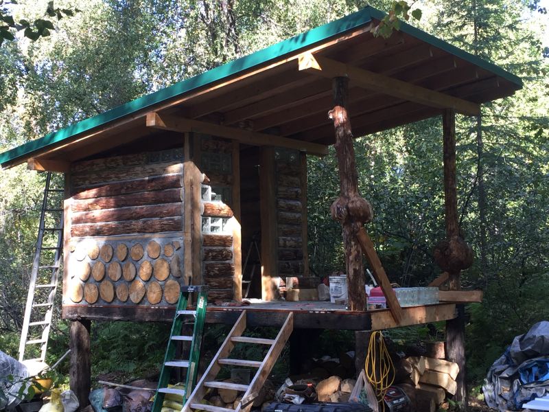

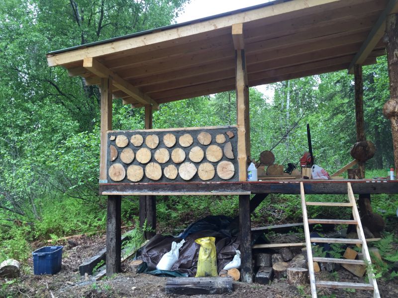

Here is my sauna in Alaska where I have Rail Road ties 4' deep and cemented. It is 8*16. As you can see it is heavy, hasn't heaved yet...
