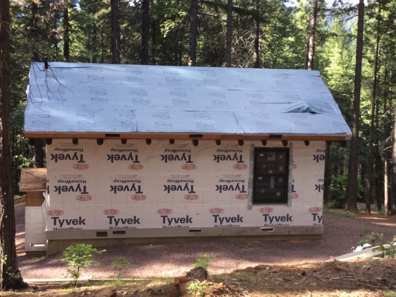

I used a different type of fire vent, with interlocked metal channels that make a baffle which, supposedly, prevents entry of embers or water in high wind.
https://www.brandguardvents.com
Location of eave vents is important. In the usual location at the bird blocks, embers get blown in when fire wind blows embers against the house. The embers and air go up the wall and get trapped under the eave, creating pressure the forces the embers into the vent to the attic. One solution to this is an eave-less building, but then you have no water drip away from the walls.
One solution is to put the vents on the outer edge of the eave, if you have a soffit air space where air can pass (see photo)
Another proposed solution is to put the vent on the roof just above the bird block line. But this requires cutting the plywood there, which compromises shear transfer from walls to roof diaphragm. Note vents in edge of eave
