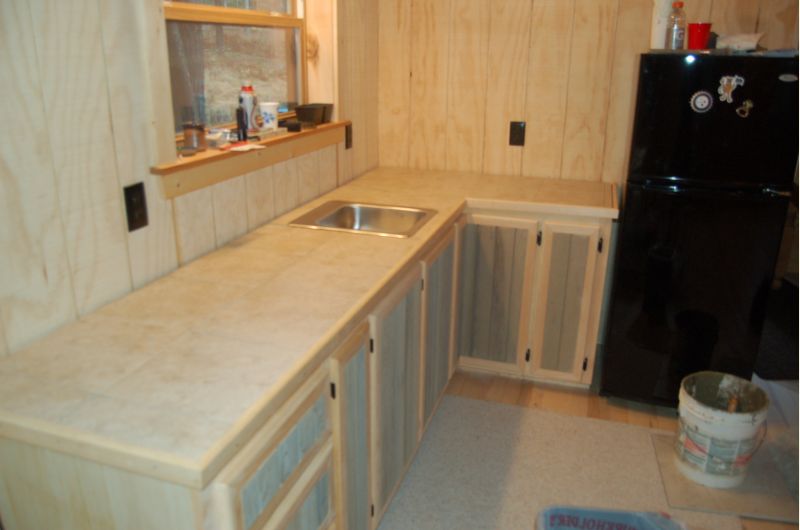

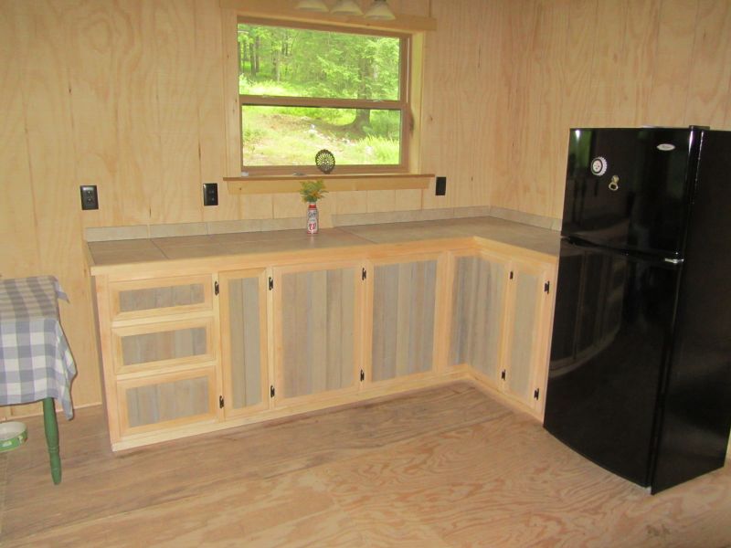

I used leftover tile from our home bathroom job and it has worked great.

People say tile / grout is horrible and unhygienic. I think that's really strange because if I prepare anything on the counter or cut anything I use a cutting board and plates. Any rough or porous surface would pose the same risks, so butcherblock or even granite could be problematic.
I would have used butcherblock for one of ours except the diagonal corner and length of one side would have been a problem for me as a DIYer.
