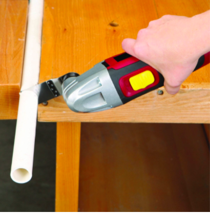

Should be able to get up there and cut it off with a cheap harbor freight Oscillating Multi-Tool. Good tool to have anyway.

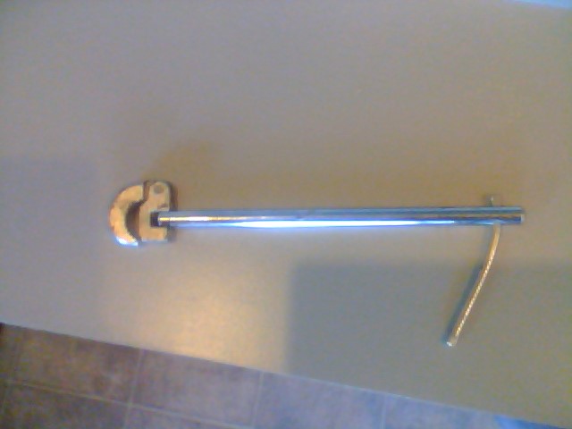

There's also a tool for every job, a basin wrench.
We bought one. It supposedly adjusted to accommodate most of these things. Well, mine were too big. Back to Home Depot it goes later on today.

# Posted: 11 May 2016 08:32pm
Quoting: Jebediah
basin wrench.
been in my tool box for years
must have
must have
