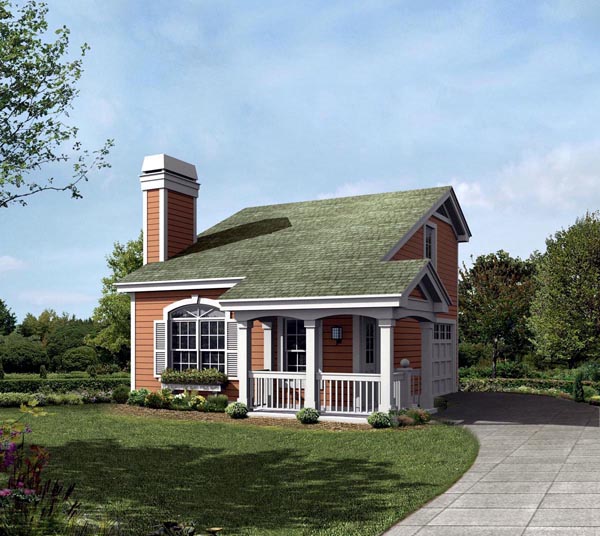

Has anyone done one? My builder will probably heave a great sigh if I suggest a change at this stage of the game, but thank me once he thought about it. With the new land and my envisioning things on it, a Saltbox (from my years in New England) popped into my head. Gosh, it would be a good style for what I want.
With the roof slope, it would shed snow and water like nobody's business and the roof line is straightforward and simple. I could have a half loft on the "high" side very easily with the ceiling height I need and then a half-cathedral ceiling. I read on Green Advisor that Saltboxes are very easy to insulate and energy efficient for a number of reasons.
You don't see many Saltboxes built outside of New England. I'd have to find plans for one or have architectural drawings made, I guess. They're really just a modification of a Cape Cod gable roof.
But I'm exploring and pondering. I think a Saltbox might be just the ticket.
A cabin version something like this, without the garage and fancy stuff, of course, and smaller footprint.

Don_P I've seen the long roof typically on the back, yeah, and the shorter on the front but I've also seen the type I posted, too. There are a few modern variations on the saltbox that are kinda neat but I'm generally not a fan of modern architecture.
Can't recall the exact footprint of the one in the pic but it's not big. 24X30, maybe? And that includes the garage. Living space-wise, it's about 320 upstairs and a bit more than that downstairs. If the plans weren't so dang expensive, I'd order them because it might be a good base from which to work. If I can't find anything else quickly and my builder is willing to take on a Saltbox, maybe I will.

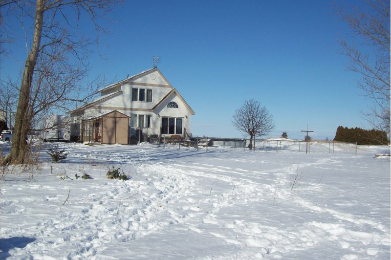

# Posted: 11 Apr 2016 09:12am
South side of my sons home .. hardly a cabin,, design by jenish.com 28 x 28 full bacement

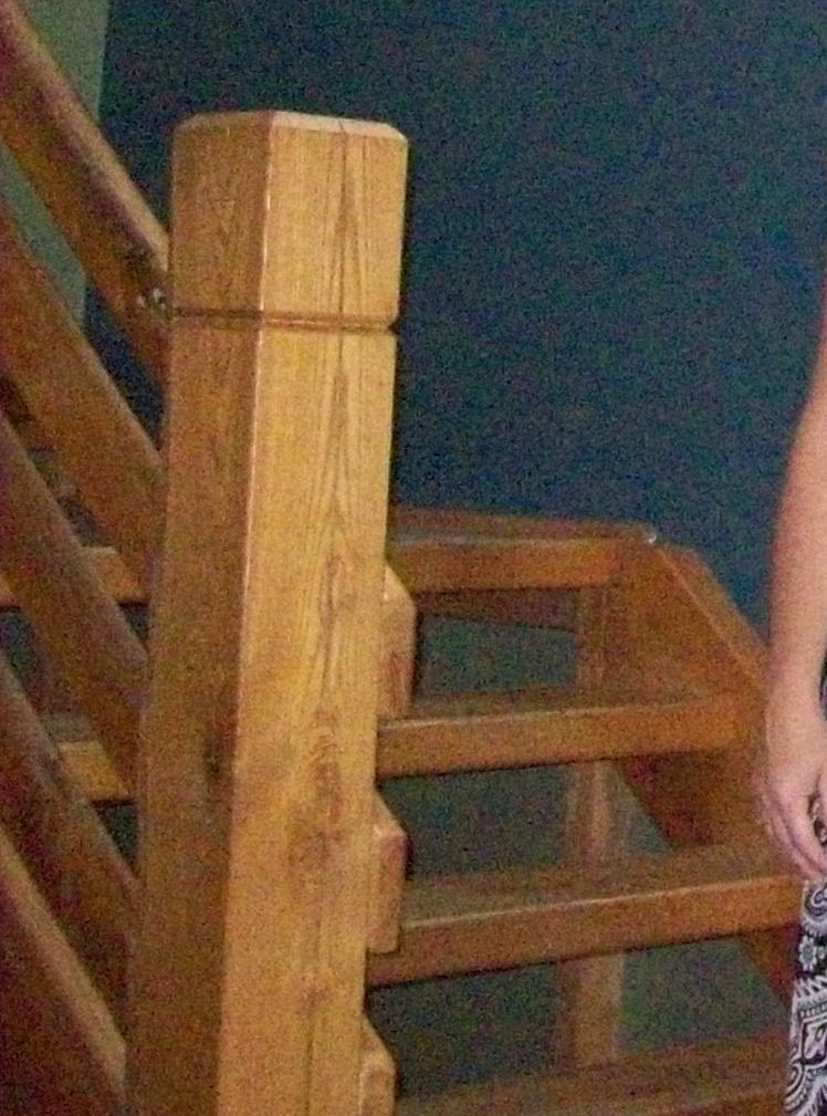

|  corner stair
Julie2Oregon
# Posted: 11 Apr 2016 03:15pm
Oh, what a beauty, Just! That's a good-sized house! Not a cabin but not a behemoth, either.
