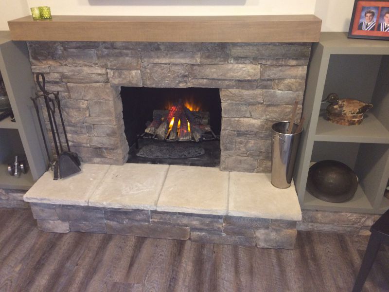

I did a very similar stone on my home fireplace last year. Mine was "Cultured Stone". I wanted to get the stones tight with no visible mortar joints so I beveled the back edges a bit with a diamond wheel in an angle grinder.

That's really good looking. I've been thinking about what to use for the hearth ledge. I like what you did. They look like about 15x15 stones. where did you get them?

The hearth ledge is Cultured Stone also. The hearth stones can be found here. They have a colour guide which you can use to find complementary colours.
Good luck with your project. I'm sure it will look great when you're done.

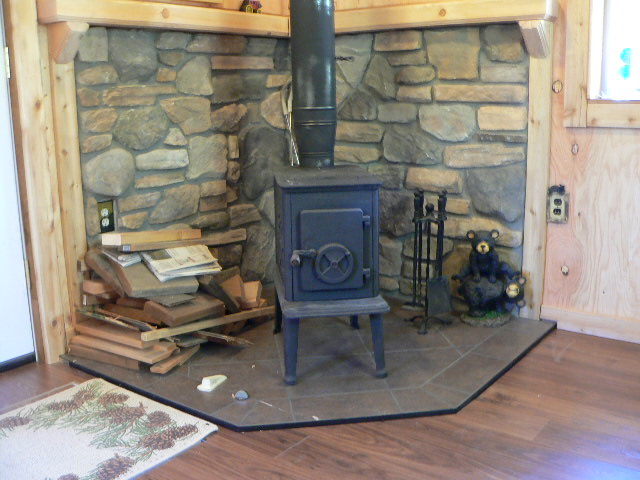

I used a similar product as well. I don't have the box anymore to give it a name, but I bought it at Lowe's. The company who manufactured it has two different kinds of adhesive. One is made specifically for heat applications. I had to redo the job since I didn't wait long enough for the adhesive to set, so some stones fell off. Other than that, they are great. Maybe a little too modern looking. I like Toyota's stones better.
