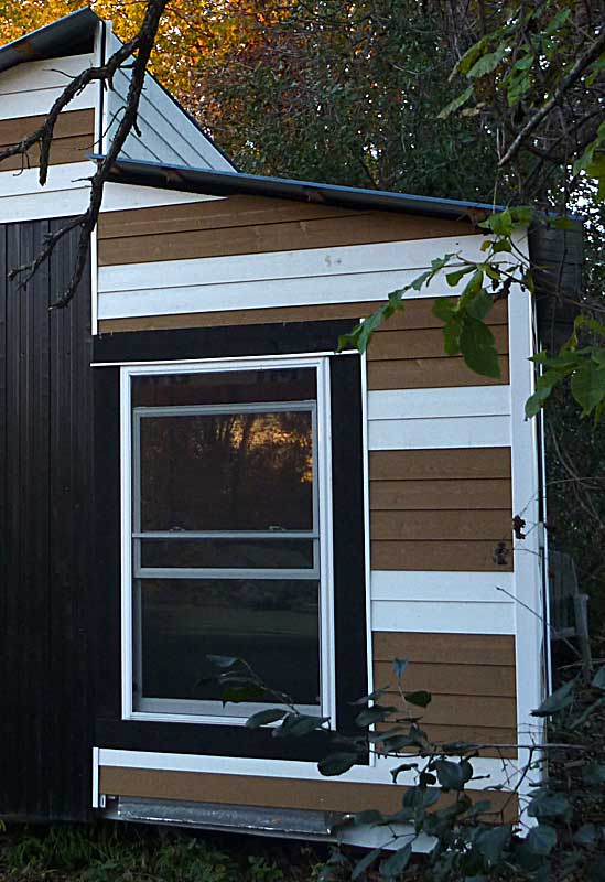

here's what I did with my shou sugi ban. this is burnt cedar in the honourable japanese style. about as simple as it gets. cut the wood square. longer top and bottom.
note that the window itself is completely wrapped with that shiny sticky waterproof tape then those edges got a strip of red house wrap tape. You can also see I put a drip cap over the window behind the top layer. and that is also taped with red house tape.

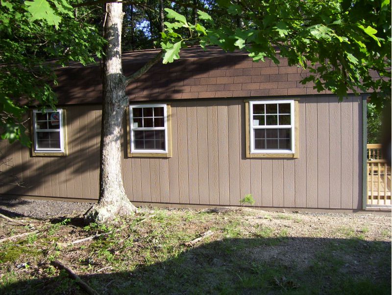

Wilbour... I did something similar to what you mention, with PT 1x4's. I wouldn't do this on my house, but it worked fine for my cabin (most of things I do on my cabin I wouldn't do on my house ). And please note- since this picture was taken, I painted the trim forest green to match the rest of the cabin trim.

That's pretty much what I was talking about. And my siding to boot!
