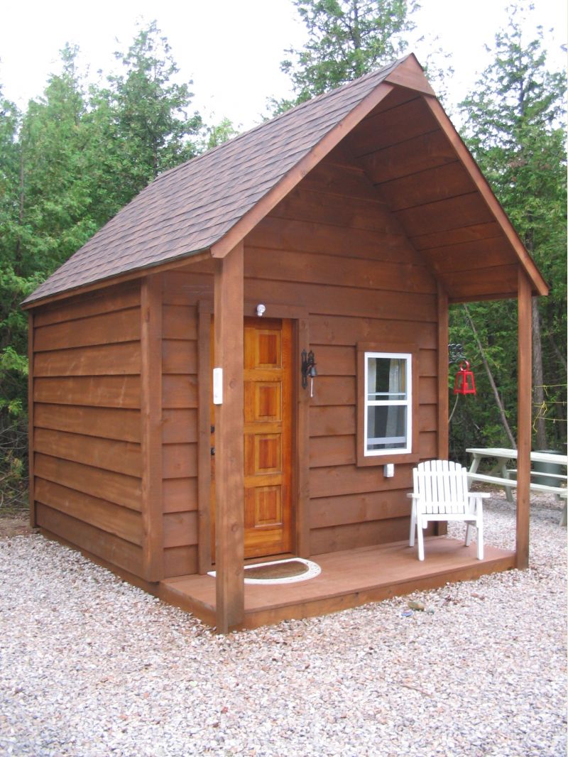

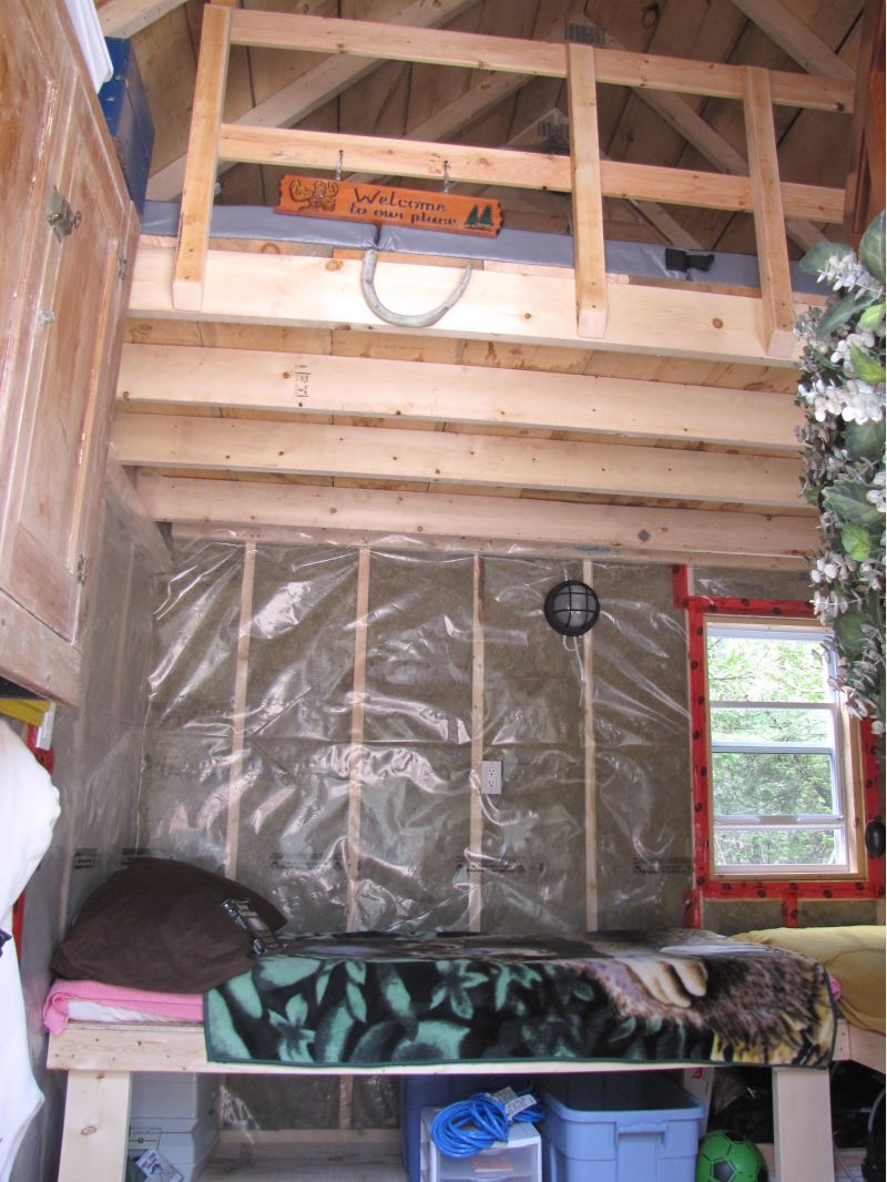

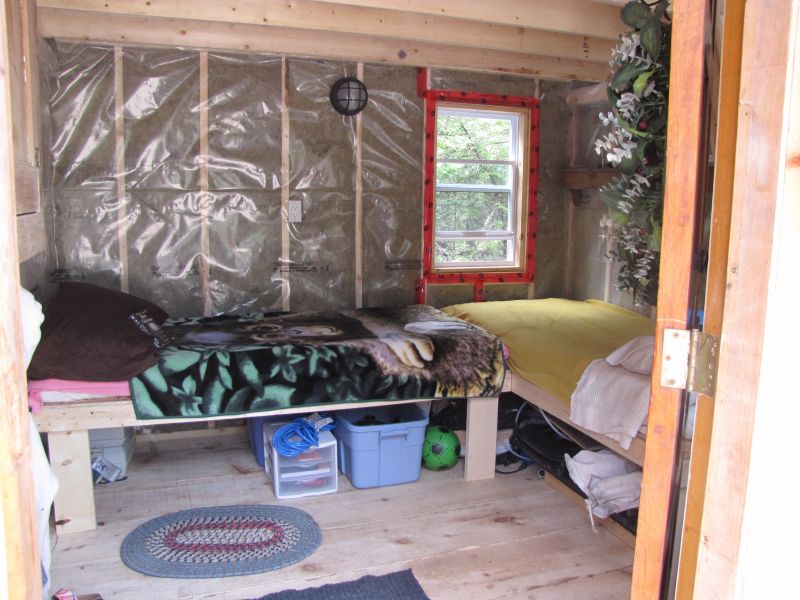

Hi MtnDon...some advice?
My 10 x 10 Bunkie is 14" tall....the loft is 6' at the peak with open rafters (2x4).
In my zest to want to sleep over in my new bunkie last Feb.2010, I insulated with fibreglass batts and vapour barrrier...did the same in the loft.
Things were great in Feb. with my propane heater
(Canada -25c)...but came up in April and noticed moisture dripping from the vapour barrier in the loft...thought I had a leak!! Tore it all off and found no leak...but the 2x4 rafters were wet...even with some minor mould starting...couldn't belief how fast it all happened!
Though I have a large window in the loft, I have no soffits or roof vents.
My plan is to reinsulate the loft with styrofoam board...leaving air space between the foam board and roof sheathing, as well as space at the bottom and peak for air circulation...no vapour barrier.
I'll probably just cover with pine tongue / groove at some point.
Advice??

# Posted: 25 Feb 2011 04:09pm
bushbunkie. a lot (most?) of that moisture may have come from the non vented heater. Other sources are cooking and breathing. Can't do much about some of those. Yes, mold is all around us in the air, when it finds a spot it likes it grows quickly. If it gets too cold it stops and then starts growing again when it gets warmer. BTW, clorine bleach does not kill mold, it just bleaches it so you don't see it. There are special mold killers available.
The space under the roof needs to be vented at the bottom and top so outside air can circulate bottom to top. A one inch space is what is usually spec'd as a minimum space.
The only good sealed rafter spaces I know of are those with spray foam on the inside or those with rigid foam applied on the sheathing on the outside.
The rigid foam board (blue or pink in most places, not the white bead board) could be cut to fit between the rafters. I have done that and have sworn I will never do that again. Lots of labor and bother, IMO, especially when sealing all the edges is included. Alternatively install the foam board right over the studs from the inside. Reduces headroom a little but much easier to do. Your choice of course.
If that is done in two layers with staggered and taped/sealed seams it makes a good barrier. Some caulks "eat" foam. There are special ones that do not.

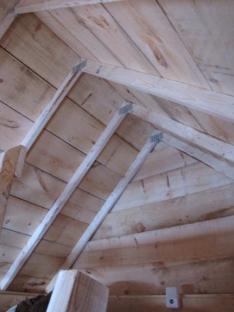

bushbunkie. One other detail. The roof peak has no collar ties. They can be 1x4 material cut to connect one rafter to another. Every other rafter would be fine. They also help keep the roof peak from peeling apart in conditions of high winds. The would be code required, but in non code areas it's up to the builder.
From the photos it is hard to tell how the tops of the side walls are tied together. Do your loft joists connect the wall tops? That is perfect if they are at the top of the wall. If the loft is not full length a 2x4 or bigger that connects from one side to the other will halp to keep the tops where they should be. Rafters put two forces on the side walls where they connect, straight down and horizontally outwards. A rafter tie every other rafter or every 4 feet minimum, used to be good practice. newer calls for at every rafter. Every 4 should suit your application.
bushbunkie
# Posted: 25 Feb 2011 05:04pm
Thanks MtnDon.
The loft is 10' long and 6' wide (front entrance is open 4', clear to the peak.)
The loft joists are 2x6 , at the top of the wall and run the entire length of the cabin connecting the walls. The 2x6 loft joists are mounted every 16".
The actual roof is not sheathing or plywood, but made up of 14' lengths of 1 1/4 " barnboard running length ways.
The extra 4' extend out to make the front porch.
Do you think I still need the rafter ties? Great advice so far, by the way...thank you.
loft joists
loft joists
Bunkie w porch
Bunkie w porch
# Posted: 25 Feb 2011 06:15pm
If they are as described they are rafter ties and loft joists both.
A tie across the front over the porch would help strengthen that area. Think in terms of triangles. Boards or 2x nailed together in triangles are stable. Something has to break before they shift or give way.
The boards on the roof are okay but diagonal would have been more able to resist racking. Triangles. But with lots of nails and boards snug like that you should be alright.
