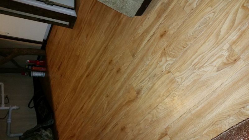

No glue vinyl planks from HD. Got on sale. Easy clean easy install. Been in a year now with heavy use

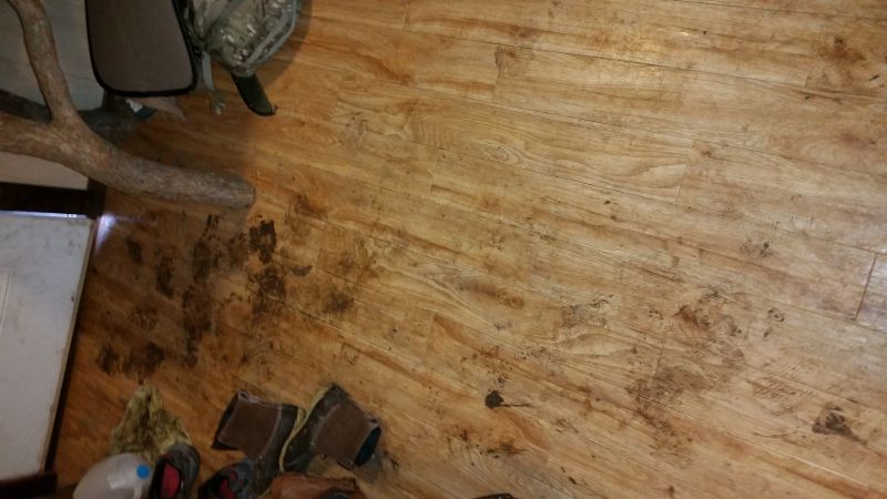

I'm happy with it. When I say heavy use I mean heavy use its like this every time ot rains. Two kids spilling food, work boots. We don't even try to baby it. It is cold. Winter time gets a nice big throw rug

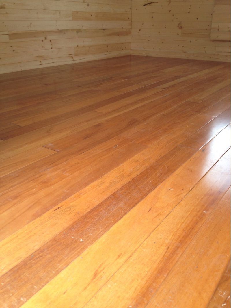

I found some 3/4" cherrywood at lumber liquidators that was "damaged" for about $1 a sq ft. I can see a few scratches but nothing major. Cheap for a small area 120 sq ft cabin.

nik. that cherry looks awesome. i have a friend who put in cherry. it darkens with age and just keeps getting better looking. she put an area run over hers and now has this neat not aged (where the rug was) aged. nice.

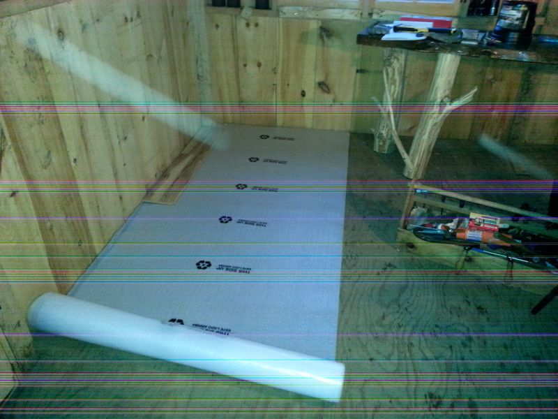

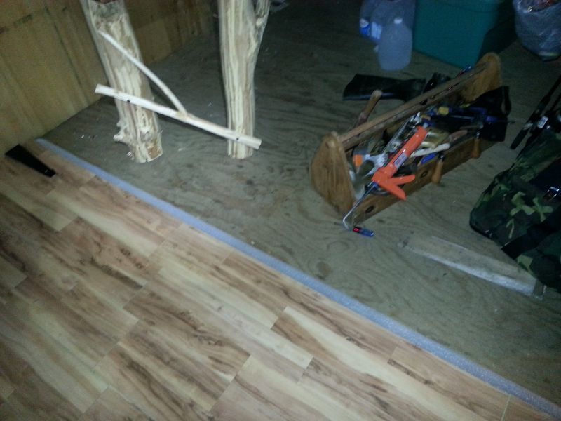

# Posted: 20 Nov 2014 04:09pm

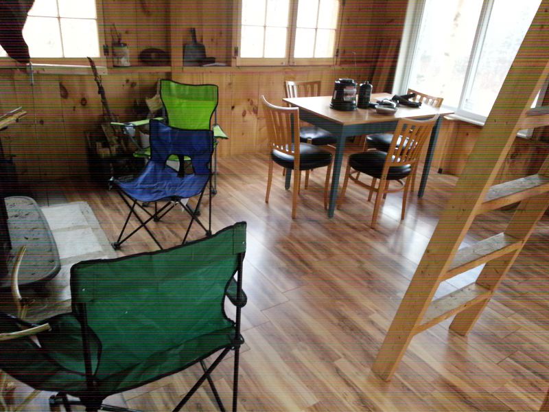

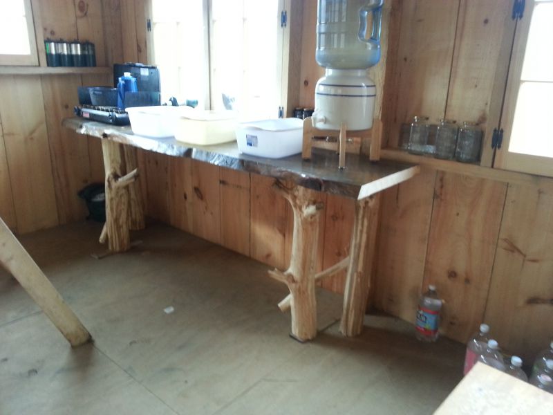

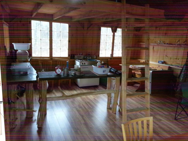

Last weekend I installed about 300 sq ft of laminate flooring. From an appearance standpoint, its a game changer (at least compared to the plywood flooring that was there before). The laminate strikes me as very durable as well. Could't beat the price either, so overall I'm extremely happy with the outcome (Thanks 22Hemi13 for the recommendation).
A couple aspects of the project I'll pass along as well, My floor turns out to be a bit wavy, so some of the laminate seams are not as tight as I would have liked. The floor is slippery as well and takes a bit of getting used to. Total job took a full day to install.
Here are a couple before & after pic's;

ColdFlame
# Posted: 20 Nov 2014 05:50pm
Looks great WheelervilleJerry! Did you use an underlay, or just lay straight on top of your plywood?

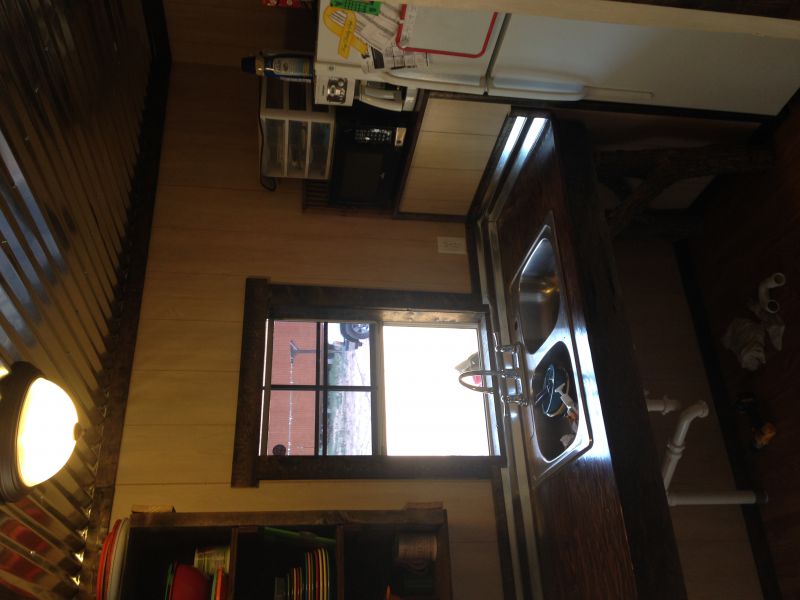

22hemi13
# Posted: 20 Nov 2014 07:11pm
I kinda did something like that with my counter

# Posted: 21 Nov 2014 06:25am
Coldflame, I used a foam pad under the floor. I went with t the least expensive from Home Depot as the floor itself is insulated. Here is a picture.
WheelervilleJerry
# Posted: 21 Nov 2014 06:29am
22Hemi13, very nice counter. I still have plumbing to do to tie in that stove/sink/fridge combo unit.
