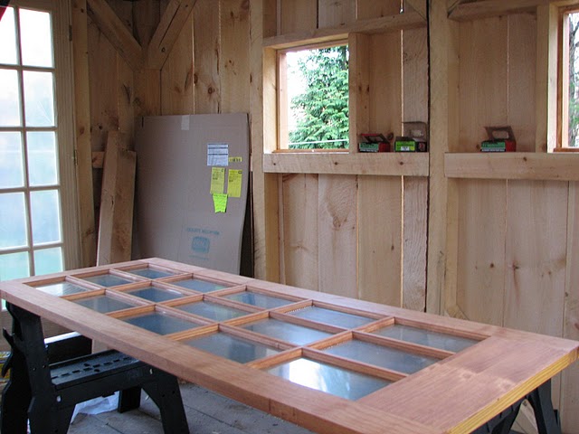

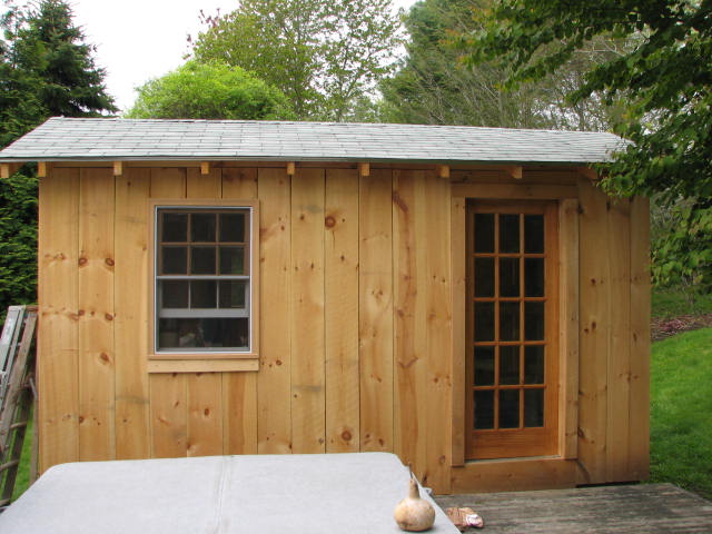

Here are some pictures. The first is one of the Home Depot doors being sealed with a wood preservative and the second is the finished studio with the door mounted. This is on the north side so it gets hit by rain.

I should note that part of the blame should be shouldered by us; these were supposed to interior doors but we put on wood preservative and figured that they would be OK since they were solid wood. But we were snookered by Home Depot; the doors are not solid; plastic on the inside with a veneer.

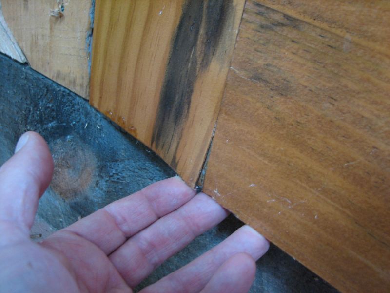

This pictures is actually on the side of the door and you can see the delamination.

i am not a fan of either of these stores but is sounds to me like you did not read the labels. there is a difference between a solid wood door and a solid, wood door. by your own admission you knew it was a interior door and you "thought" it would be alright if you sealed it...not. stainless hardware and screws are softer than carbon steel screws. next time you should use a coated exterior screw. like i said , i am not a fan of depot and always support small business but if you're gonna make a deal with the devil you must read the fine print and do your home work.
avan
# Posted: 21 Jun 2010 02:56pm
What I can see is you buy inside use material, this is in interior door. glue are not made for the element like humidity form the rain snow, etc... the only way to use that product outside are when FULLY coated with epoxy.
fthurber
# Posted: 21 Jun 2010 08:21pm - Edited by: fthurber
Yea without question we were trying to push the limits. If the door had been solid wood as they appeared to be then it would have worked. But this is not the first time I have been snookered by Home Depot; just about everything I have gotten there is junk. And as far as the drywall screws...I have gotten properly tempered stainless screws from the local hardware guys and they are as hard as flit and work beautifully. When I get a chance I post will some pix of some hi-tech self-tapping self-counter-sinking stainless screws I have be using from the out local hardware place (JT's lumber in Rhode Island).

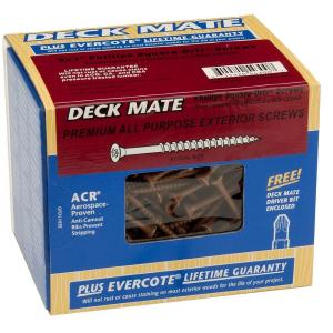

Yeah, I experienced that too. Very frustrating when on the job site 60 mi from a store...........
Never had a problem with their deckmate screws though, of which it's best to use their drivers, never a skip, or material failure.
Again, makers of brand items seem to try to snag the bigger market with some inferior quality product, but it's mostly up to the buyer, and astute shopping.............model number comparisons, etc....
